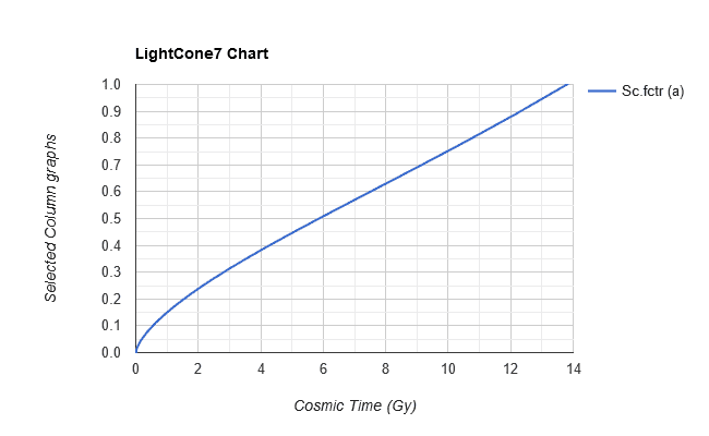

So, if there is an acceleration in any part of the history of expansion, in the time any two objects have moved apart due to expansion, then this method of testing it against the known age of the universe might not work, or if it yields the current age it might call into question acceleration.
The thing is, for the first half-ish of the history of the universe, there was deceleration. Acceleration has been happening during the other half or so. So you have a curve that slopes one way for about half its length, and then the other way. This makes using a straight line approximation kinda-sorta give the correct age:
This graph shows how all distances have changed over time, growing from 0 to their current size (i.e. scale factor = 1). You can see that it took almost 14 billion years for any distance to grow to the current size. The curve sloping downwards at the beginning is deceleration. The later acceleration is less pronounced, but it's there.
You can perhaps see how you could just about replace this curve with a straight line starting at the now point (13.8, 1) and initially tangent to the first bit of the curve, and not get that much of a different result as to where it crosses the x axis.
Thanks Bandersnatch! I have an expansion motion simulator and I was able to generate a chart from the perspective of the observer that looks a lot like this graph (I have to set the observer out of sync with the Hubble flow to cause it). I plan to play with it some more to help me understand. I would post the chart here but I don't want to get band.
Thanks again.
