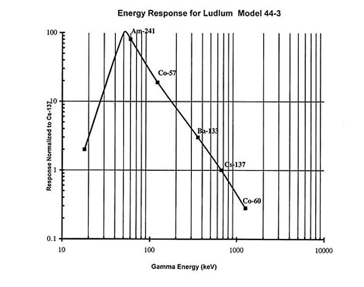

The problem with this particular probe is that it is meant for low-energy gammas. Most sources of radiation that you might be interested in are fairly high. The problem is the sensitivity and therefore the cpm/ millisievert is dependent on the radiation energy.
Here is an energy response curve from Ludlum
As you can see the cpm varies significantly for the energy of the gamma so radiation exposure rate for a given isotope will not be the same for a given cpm reading.
Here is an energy response curve from LudlumView attachment 291421
I understand, but I'm seeing these high readings from just the background.

Count rate depends on how the pulse-height discriminator is set. What electronics are you using on the Ludlum detector? I have not seen anyone here talk about pulse-height. The graph that Gleem posted is not counts per minute; it is energy of the pulses, which is proportional to pulse-height.
The detector you purchased is more of an x-ray detector than a gamma detector, because it is only 1 mm thick. You should use Am-241 from a smoke detector as a check source. There is both a gamma and x-ray from Am-241 to use to calibrate how to set your discriminator level. You can look up the eV; the gamma is near 59KeV if I remember correctly. So, you should see the two peaks and then you know what you are looking at. Set the discriminator to see only the larger peak (the gamma) on a pulse height analyzer. If you do not have a pulse height analyzer it is very difficult to make sense of these counts.

The instrument that is used with the probe is the Ludlum model 3 which is just a pulse counter/HV supply which can also be used with GM tubes. The graph which I posted is to indicate the sensitivity to various energies of his probe. The threshold setting is fixed.
