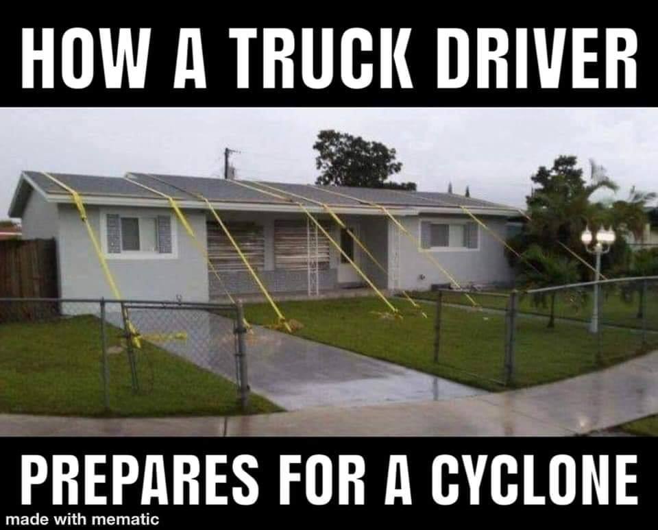

@davenn posted the following in the Lame jokes thread:
davenn said:
Very funny, but I wonder how realistic this would be. What kind of anchoring could one use that would actually help in stopping the roof from blowing away?
DrClaude said:
Summary: How to stop a roof from blowing away in a storm?
I was considering something like angled stakes into the ground ... very long/large tent pegs
Dave
Yes, but considering that it appears to be bracing for a storm that could uproot trees, would that any significant resistance to the roof blowing away?

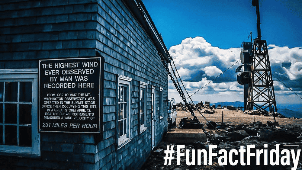

It's real! The picture is from the summit of Mount Washington, NH, USA. They claim 100/100 climate there meaning that the wind blows more than 100 mph 100 days per year.

I'm reasonably certain this was discussed before and the answer is yes. The tough part is estimating the lift; you can easily calculate the down-force from the straps using the angles and rated strength.
I remember when we did a Navy trip to Australia in the Early-mid 80s and the houses there, like in Darwin, all had to be cable-stayed to the foundation. Cables had to go up inside the wall, contain the roof members and down the opposite wall to the foundation so as to keep them together and not smashing the house next to them also.
So I know that such IS in use in the building field. So while the one Davenn posted was a nice chuckle, I was snrking to myself because that was really done right, with the boards along the edges under the stays to keep the edges from tearing upwards. Truckers are used to the high speed winds and tie-downs, so are not to be neglected or laughed at if they start setting up like that.
