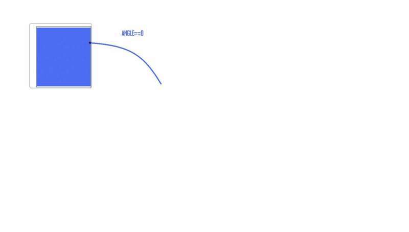

Correct me If I'm wrong , It's not a projectile motion, there is no angle, it is "shot" horizontally.
well anyway, My answer is not 6.7.
initial speed = LaTeX Code: \\sqrt{2gh}
now the initial height is : H-h, h is the distance from the top to where the hole is punched.
Using kinematics You should get D(distance)=Vi*Sqrt[2(H-h)/g)]
put Vi to the equation, and you get a function D by h.
Now How will You get the maximum distance of a function of distance??(hint:math! 2 ways to find the h,using derivative or by a law in math, that sqrt(m*n)<=(m+n)/2 always! , and sqrt(m*n)=(m+n)/2 when m=n, where do You see that in our problem?)
Good luck,Tell me how it goes,I hope I'm right anyway :P

I don't think we understand each other, Of course the maximum range is when shot in 45 degrees,but i Don't think that It's related to the problem, The solution I wrote is IMO correct, this is what i think happens in the problem, maybe I understood it Wrong.
What do You think?
