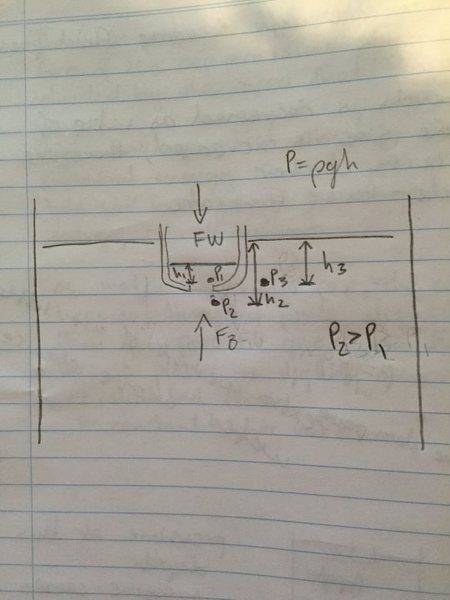

Hey everyone, I'm new to physics forums and I would really like some help with my physics report. For my high school physics topic I have chosen an experiment where holes with differing diameters are drilled into the centre of the bottom of PVC pipe caps and the time taken for the each cap to fully submerge below the water line is recorded. Could someone help me with my overall understanding of the topic and how it may relate to Bernoulli's principle?
1. Homework Statement
I've conducted the experiment and this is what I know:
When the cap is dropped, the force weight is slightly larger than the buoyancy force and PVC is more dense than water. The buoyancy force upwards will result in water rushing through opening of the hole in the bottom of the cap. As the water rushes into the cap, the cap becomes heavier and consequentially the buoyant force is slightly smaller than the force of gravity on the cap because the PVC is more dense. Increasing the diameter of the hole size results in a higher flow rate as the larger the diameter of the hole is, the more liquid that will flow through it, that would otherwise be motionless at the bottom of the cap. Furthermore, smaller the hole is, the ratio of water touching the inside wall of the hole (and therefore at a zero velocity due to the no slip condition) to the water actually rushing through increases.
Questions:
Why does a higher flow rate decrease fluid pressure and how does this apply?
What is the relationship between the liquid outside the cap and the liquid inside the cap? note: the water level is higher outside than inside
Will the pressure of the water going through the hole change?
Will the pressure due to the growing column of water on top play a role?
Hard to answer this one without breaking forum rules and actually telling you how to solve it .
Let's have a go and see how we progress :
Draw me a picture of the cap sitting partly submerged in a large area deep pond of water . Represent the cap by a piece of vertical axis tube with a flat bottom .
Show where the level of water inside the cap is likely to be relative to the pond surface level . Just use your intuition .
Label the drawing and show any dimensions that you think relevant .
Show any pressures and forces that you think may be acting .
Once we have a good picture we can move on .

Best to work on the general problem first before introducing actual values . So use symbols like p1 , Fv , h2 etc for your annotations .

I should have mentioned the bottom of the cap is a dome.
I know that pressure is a dependent on depth from surface of water. Therefore, the pressure at a point in water inside the cap will be less than the pressure at a point of the same height outside of the cap (as in height from ground). So am I correct in saying that P2 is at a distance of H2 from the surface of the water as demonstrated in the diagram? This would tell us that the their is a greater force acting on the water particles outside the hole compared to inside the hole, and this is what is causing the water to rush in.
Thus, if the hole was larger, the pressures would be the same (initially) and therefore a larger hole simply allows for more fluid to flow into the cup?
Are these conclusions valid?
