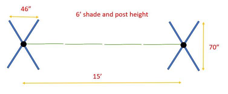

Hi guys, thanks for helping me! I am working on a home project that includes a privacy shade for my backyard. I have a 6'x15' vertical shade attached to two portable posts that are held up right by four legs ("X" shaped footprint). the surface footprint of the legs covers an area of 46"x70". I am trying to figure out how heavy my two posts have to be to keep my vertical shade from tipping over in the wind at 25mph. This will determine what kind of material I use for the post (probably steel) and if needed how heavy of a sand bag I would need to add. I calculated that at 25mph the shade will experience 1.6lb of force per sqft (not sure if this helps, not an engineer or student).

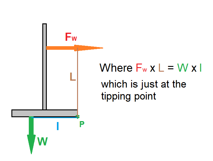

The force that I have for 1 sqft at 25mph is 2.5 lbs so yo might want to check your number to start.
Next you might want to consider gust which are about 30% larger than the average wind speed.
Your problem is basically one of counteracting torques. In this case the tendency of the screen to rotate about the ends of your "footprint" due to the torque produced by the wind. Torque is a twisting force defined as applied force (in this case the wind hitting the screen) Fw times the perpendicular distance of the line of action L from the pivot point P (in this case the end of the footprint". This torque must be counteracted by the weight of the footprint, W time the perpendicular distance of the line of action l from the pivot point P.
Now there is another problem since the feet are not connected by a ridged structure. If the wind force is not dead center on the screen the load on the footprints will not be equal. Also, the net wind force is probably not exactly 3 feet above the ground. So, you must include a safety factor. How much? That is just a guess. Perhaps one of our engineers can suggest one. Also, you need to expect in any situation of deployment that the wind might come from either direction so the positioning of the weigh should take this into consideration.

Thanks so much for your insight, so the way I am thinking is, anything under 3ft won't make it tip but any force above 3ft would.. in that case would it acceptable to calculate Fw at 5 ft? when I do the math I divide the max wind force to the total sqft of the shade or total sqft of the shade above 3ft? Also, wouldn't "I" be from the center/post to the edge of the footprint. If this is the case half of 70 or 35in?
