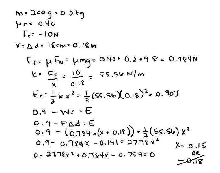

A 200 g wood block is firmly attached to a horizontal spring. The block can slide along a table where the coefficient of friction is 0.40. A force of 10 N compresses the spring 18 cm. If the spring is released from this position, how far beyond its equilibrium position will it stretch on its first swing?
(I've listed the equations and variables/given data in my attempt!)
The following is my attempt at solving this problem, but my issue is that one of my friends got a different answer (0.17 m). I tried it another way and got his answer but I don't know which one is correct (there's no answer key).
The other equation I used was (F - μmg)/k = x which gave me 0.17 m. But I found this equation on Yahoo Answers and I'm not sure exactly how they got it.
Mine looks right, but is it? Thanks in advance!
Try looking again at the forces involved at the starting postion.
Your solution looks right. I didn't double check the math, though. The other equation doesn't make any sense. You can't just pick some random equation from Yahoo and expect it to make sense.

You should have posted that link in the OP to begin with. The Yahoo answer is wrong.

I don't think you should consider friction at the beginning position. The problem says "A force of 10 N compresses the spring 18 cm" Nothing about friction here. In fact, if you include friction it becomes impossible to solve the problem since you can't calculate the friction (neither direction nor magnitude).

As I said in post #11, Adding the friction to the force doesn't make sense. Why are you adding the maximum friction? Why not subtract it? After all, the friction might be in the other direction, right? Why use the maximum friction as opposed to - say - half the maximum friction? There are no good answers to those questions. The only sensible interpretation is that there is no friction force at the outset.

Why in the world would you suppose that? There is no reason to suppose that. If anything, the friction would actually work against you - as usual. But that's not a good assumption either. Based on the question text, the only sensible assumption is that there is no friction at the set up position.

dauto just seems to be right all along. Got 1.5e-01 m here.
Looks like they dropped a factor of 2:
Initial compression = d = 0.18m
Mass = M = 0.2kg
Initial force = F = 10N
Spring constant k = F/d
Initial energy = kd2/2
Distance traveled = d+x
Work done against friction = (d+x)μMg
Final potential energy kx2/2
(d+x)μMg = kd2/2 - kx2/2
μMg = kd/2 - kx/2

No. I canceled a factor (d+x) from each side of the preceding equation. This is one reason I made the post, to show that it is not necessary to solve a quadratic.
