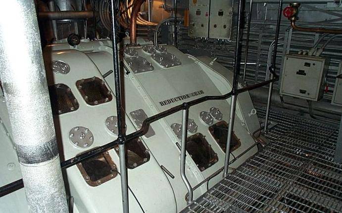

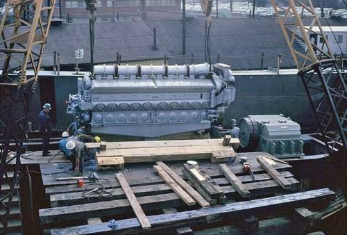

I took the engine room tour on Alaska Ferry's "M V Columbia". It has 6,000 hp diesels mechanically geared to its two propeller shafts.
It was built circa 1974.

Fascinating. How big were those darn gear wheels anyways. Took any pics of its innards? Must have been a sight.
Didnt get pictures, sad to say. Light wasn't the best and it's a crowded equipment room where one would need professional wide angle lenses.
The reduction gear is in a closed box about size of a medium moving van.
It is a sight. As you know you feel more than see big machinery in operation.

Wonder why they made that design decision. Any idea? I though in marine applications too diesel electric was fairly common.
I think it was the time. Columbia was built early 1970's when big electric drives were in infancy.
As you see, 6000 hp is a very modest electric drive nowadays.
http://www.gepowerconversion.com/product-solutions/medium-voltage-drives/mv7000
On second thought, do propellers need as much gearing as a locomotive? Is the varying resistance offered by water with propeller rpm more forgiving in terms of torque-speed characteristics? Are there many speed-gears or just a reversing gear?
Columbia was just forward-reverse gear. I think the engines ran at 650 RPM propellers around a third of that- but that's just memory so i don't trust it very much.

The reduction gears in the USS North Carolina are designed to reduce the speed of the steam turbines which propel the vessel to match the speed of the propellers. These are double-reduction units, which means that the turbine speed is reduced in two stages, in order to keep the size of the gears manageable. The high pressure steam turbine runs at something like 6000 RPM, while the low pressure unit typically runs at about 3600 RPM. The propeller runs at about 300 RPM at full load. Thus, you need about a 20:1 speed reduction to match the HP turbine to the propeller, which makes for a large gear. Also, these gears must handle about 30,000 horsepower (22,000 kW) each at full load. There are four identical geared steam turbine units which drive the North Carolina.
On the other hand, this is a picture of a medium speed GM 2-stroke diesel, 20 cylinders, developing about 3600 horsepower (2700 kW) at 900 RPM with a Falk reduction gear shown to the right:
Depending on application, these Falk gears have a speed reduction of from 3:1 to about 6:1, making for a very compact unit.
Because making large reduction gears for ships is a very complicated and expensive process, engineers have sought different methods of matching the high speed of the steam turbine with the low speed where a marine propeller operates most efficiently.
