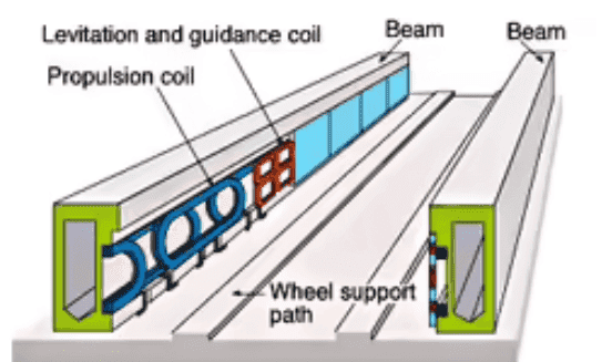

There are about 25 million km of highways in the world. Is there enough copper in the world to make the coils for that much maglev track?
Alternatively, what happens when a maglev car reaches the end of maglev track and needs to continue on conventional roads?
