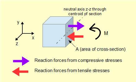

Internally, the lever experiences internal forces in forms of shear and axial pairs of forces than change along it.
Please, see:
https://www.engineeringtoolbox.com/stress-d_1395.html

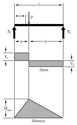

Thank you lnewqban. The shear and moment graphs are useful even If I am still trying to understand it.
I see the energy argument (work in = work out) and why the output force must be bigger.
However, it still remains a mystery from an internal stress point of view, how an externa force applied at one end generate a larger external force at the other end of the bar...

The lever is internally rigid and resists deformation; meaning that a external force induces internal forces.
Those internal forces change their magnitudes and are transferred along the length of the lever, and manifest themselves at the output end.
We could loosely say that the combination of the input force and the distance between point of input application and fulcrum becomes a maximum internal moment at the fulcrum, which becomes another combination of output force and the distance between the fulcrum and the point of output application.
