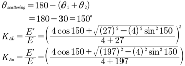

Hi,
I calculated the scattered angle & the kinematic factors for both Al & Au to be
Is what I did right?
Also
E (Alpha) = stopping power x depth
= 250 x 0.5 = 125 keV
As for the maximum & the minimum scattered energy i didn't know how?
Any feedback would be appreciated, I'm really struggling.
