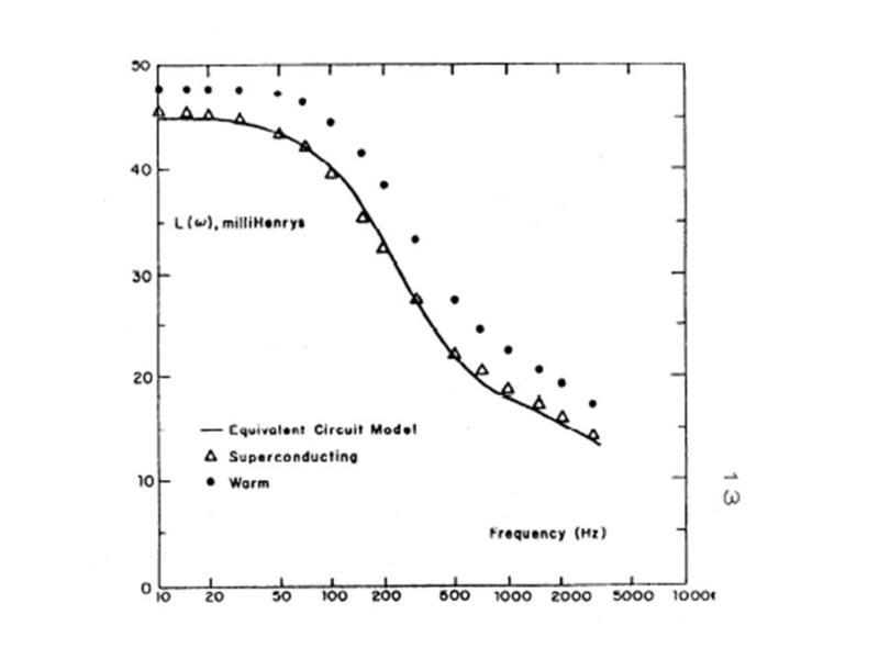

Many years ago, I measured the ac inductance (imaginary part of impedance) of the Fermilab Tevatron superconducting dipole magnets, as the magnets cooled from liquid nitrogen to liquid helium temperature (4.2 kelvin), and back. I used a 1 amp signal, with frequencies ranging from 10 Hz to 5 KHz. At about 9 or 10 kelvin, the inductance abruptly dropped from 49 mH to 45 mH at all frequencies, the difference being due to the ac magnetic field being excluded from the volume occupied by the superconducting coils (Meissner Effect). See attached jpg. The dropoff in inductance at higher frequencies is due to ac losses in laminated iron collars, cryostats, etc. The real part of the magnet impedance was simultaneously measured, and showed no change.
