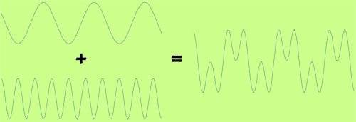

Look at this diagram for a second.
Pretend the top left wave is a lion's roar, and the bottom left wave is a bird's chirp.
These two waves add to each other, and are equivalent to the right wave.
If a speaker can accurately reproduce the right wave, we will hear a lion's roar and a bird's chirp at the same time.

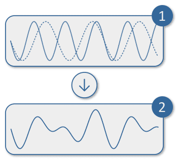

Here are some more examples of additive wave synthesis:

how can a speaker reproduce so many (billions) of different waves? (not at the same time)
As long as the speaker can vibrate at a frequency higher than the bird's chirp (maybe 5,000Hz), the speaker can represent that sound. (though if it needs to represent rich sounds faithfully, it will need to be able to vibrate higher)
It simply vibrates to exactly match the waveform on the right. How it does so is directly a result of how much voltage it is given over time.
So, that right waveform is an actual graph of the voltage passed to the speaker magnet over time.
It also happens to be an actual graph of the position of the speaker diaphragm (in very small distance units) as it moves in and out, making sound.
I think you are missing the point that the speaker doesn't vibrate at all those different frequencies, it vibrates at a COMPOSITE frequency and produces exactly the same thing that you ear gets when it is listening to all those things happening at the same time.
To expand: The human ear hears a lion roar and a bird chirping at the same time. These events separately cause sound waves but when they impinge on the ear, what they create is a composite waveform. You only have one ear drum on each side after all. The speaker just produces that composite waveform from a single source rather than from multiple sources, but it is still one waveform, it just has the composite characteristics of multiple waveforms.
When you study Fourier Analysis, you'll learn more about this.
