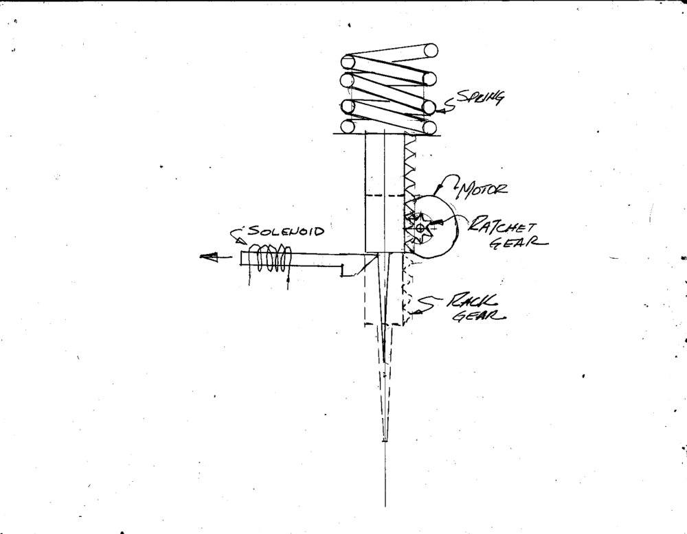

How about this?

AZFIREBALL said:
How about this?
Yes, nice proposal. But I don't understand how the solenoid is acting.
I need to trigger the needle retraction, at the end of injection, not immediately after the insertion.
You will need a timer circuit to run the solenoid and motor at the proper times.
The solenoid holds the needle up until the time for injection. It fires...the needle goes down. The timer allows 3 min. then triggers the motor to retract the needle until it is again latched up by the solenoid.
Then the cycle starts all over again.

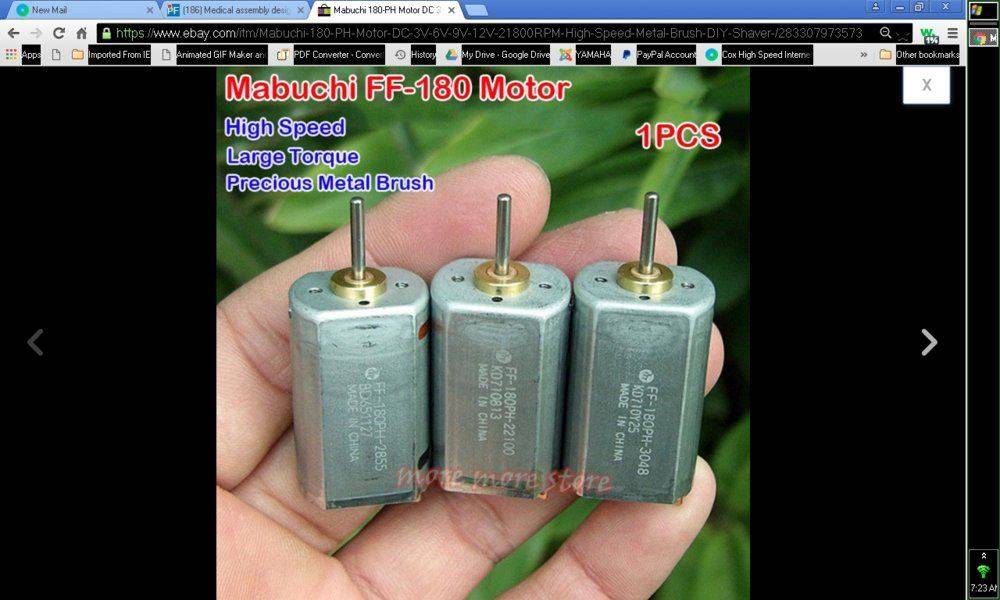

Motors like this on Ebay for $1.99 each. Too expensive? How much have you budgeted for this project?
