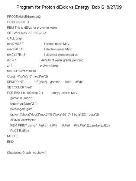

Here is a thumbnail plot of dE/dx vs. Energy, and the program for it.

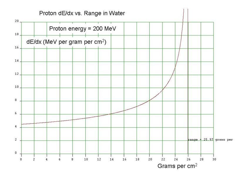

Here in thumbnail I think is a proton dE/dx plot vs. range in water for a 200 MeV proton. There is no range or energy straggling included. The max range was 25.9 grams per cm^2 (25.9 cm). Please check against your tables.
[Note: the plot has been updated]
Note 2: Look up Geant at http://wwwasd.web.cern.ch/wwwasd/geant/
hi bob, first, thank you, really so much!
even if i don't know the program you used to plot the first graph, that is the "classical" BB formula, i'd already achieved that result and that graph.
the problem i have now is to obtain the second graph you posted.
have you obtained it using geant (i'm trying it!)
or have you written a program similar to the previous one?
with which forumula?
thank you so much!
Ciolla-
The second plot was done using my own program similar to the first one, by numerical integration of the Bethe Bloch equation. The only tricky part is getting the correct ionization constant, because the approximation that I =10 for every material is only approximate. Furthermore, my curve is for only a single particle, so the range spread from incident beam energy spread and range straggling (including multiple scattering) is not included. Here is another site (besides GEANT) for proton and alpha particle range data for literally 100's of materials (National Institue of Science and Technology):
http://physics.nist.gov/PhysRefData/Star/Text/contents.html
Bob S

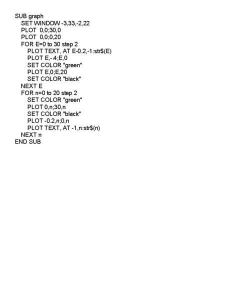

Ciolla-
Here it is. It is written in TrueBasic.
Bob S
hi bob! step by step, you are saving my week! :D
thanks for the program. however, I don't know true basic. btw, I'm trying to understand the process to translate it in C. let's try to sum up:
- you define all the stuff..
- you define the starting point for x and E.
- an iteration starts, from 0 step by step in x
- you define gam, bgam, beta as functions of total energy E
- you define the function to plot dE/dx
- you plot a single point (right!?)
- the cicle ends when E reaches 0
it's ok?
my remaining doubts:
-- the command: "PLOT x,0" -- what is it for?
-- the command: "xx=round(x,2) ??
-- isn't gam defined as E/mc2? why do you use 1+E/mpc2?
thanks so much bob!

Hi Ciolla-
1) Looks good.
2) "Plot x.0" terminates the "plot x,dEdx" commands by drawing a vertical line down to the horizontal axis.
3) "xx=round(x,2)" rounds off to two places (but don't really need it here).
4) I am using E as kinetic energy in the program. Sorry for the confusion.
Bob S

Ciolla-
Here is a plot (see thumbnail) of the energy loss ionization constant for the Bethe-Bloch equation plotted vs. Z of the target material. I told you earlier that IZ (in my program) was about 10*Z, but it does vary a little bit, depending on Z.
Bob S

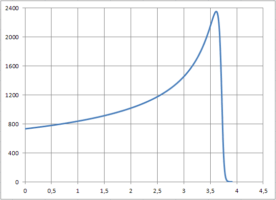

Thanks Bob,
I rewrite your code in Python, and get same graph. Here is the code :
import math
mpc2=938.27 #proton mass in MeV
mec2=0.511 #electron mass in MeV
re=2.817e-13 #clasical electron radius
rho=1 #density of water in grams per cm3
IZ=75 #ionisation constant for water times Z-eff
Z=1 #Z proton charge
TZ=10 #Z-eff target
TA=18 #A-eff target
n=6.02e23*rho*TZ/TA #target electron density
konst=(4*math.pi*n*Z**2*mec2*re**2)
f=open('F:/proton_water.txt','w')
x=0
dx=0.01
Estart=5
E=Estart
while E>0:
x=x+dx
gam=1+E/mpc2
bgam=math.sqrt(gam**2-1)
beta=bgam/gam
faktor=(1/beta**2)*(math.log(2*mec2*1e6*beta**2/(IZ*(1-beta**2)))-beta**2)
dEdx=konst*faktor
dE=dEdx*dx
E=E-dE
xstr=str(x)
dEdxstr=str(dEdx)
data=xstr+','+dEdxstr+'\n'
f.write(data)
print x,dEdx
f.close()

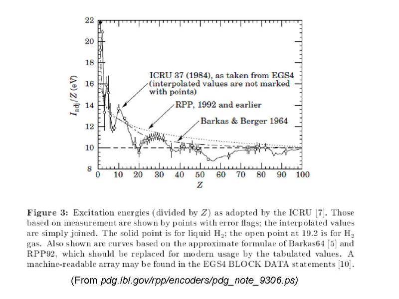

Now I want to reproduce Bragg Curve for alpha particle with energy 5.49 MeV in air. Air composition is 80% N2 and 20% O2. I guess I have to change the value of Z, IZ, rho, TZ and TA. I changed Z = 2, TZ=30, TA=60, rho=0.0012, and IZ =16*TZ^0.9, and run the code, but I didn't get the correct curve.
A 5 MeV alpha particle is very non relativistic, so the Bethe-Bloch equation has to be modified. A good discussion is in the paper
http://www.hep.wisc.edu/~prepost/407/alpha/alpha.pdf
Another problem is that the slow alpha particle occasionally picks up an electron from the air, so the alpha's apparent charge is e rather than 2e. This extends the range a little.
Fig. 3 in the reference is taken verbatim from page 650 in Evans The Atomic Nucleus (1955). It shows the range of a 5 MeV alpha to be about 3.5 cm of air. Evans is worth reading, from pages 637 to 650, if you can find a copy.
Bob S
