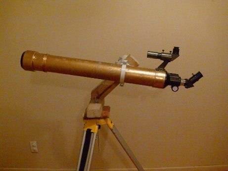

i have designed and built a small 3" f11 refractor. the optics are available from the suplus shed for about under $50. all the other parts are available from the Depot. only need a hacksaw and a screwdriver to put it together. total cost under about $80 usd. it is a two element acromat. good for planets and solar. I can send you all of the build details if you like. should be able to fully asemble it in a couple of hours or less. it is called the little golden telescope. it is simple to build and easy to use. here is a pic of it fully assembled with guide scope and tripod. ( can be baught , cheap servayours trypod about $40. the mount is a simple unifork altitude azimuth mount built out of scrap 4x2 timber. very solid and stable.
