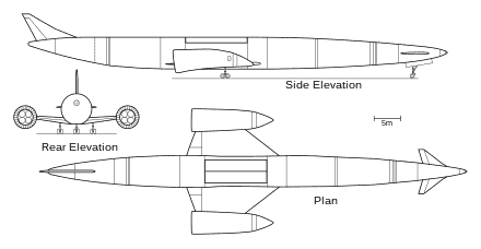

Sounds like you want to re-invent Skylon. Horizontal take-off, air-breathing engines until it transitions to pure rocket propulsion. Uncrewed, $12 billion estimated development cost over more than 10 years, with the idea to sell individual vehicles for $1 billion each.
Interesting. But those landing gear look pretty undersized for a 700,000 pound craft... :wink:
A special runway will be required for launch: it needs to be reinforced to tolerate the high equivalent single wheel load;[75] necessitated by the Skylon's 325 tonnes takeoff weight; it will need to have heat resistant sections[citation needed] at the start of the take-off run and at the rotation zone;[76] and it will have to be 5.9 kilometres (3.7 mi) long[76] to allow the Skylon to accelerate to its 155-metre-per-second (300 kn) rotation speed,[77] yet still have 1,500 metres (4,900 ft) to abort the launch and brake to a standstill if required. The Skylon would be able to land on a 3.2 kilometres (2.0 mi) Code F civil runway.[76]
