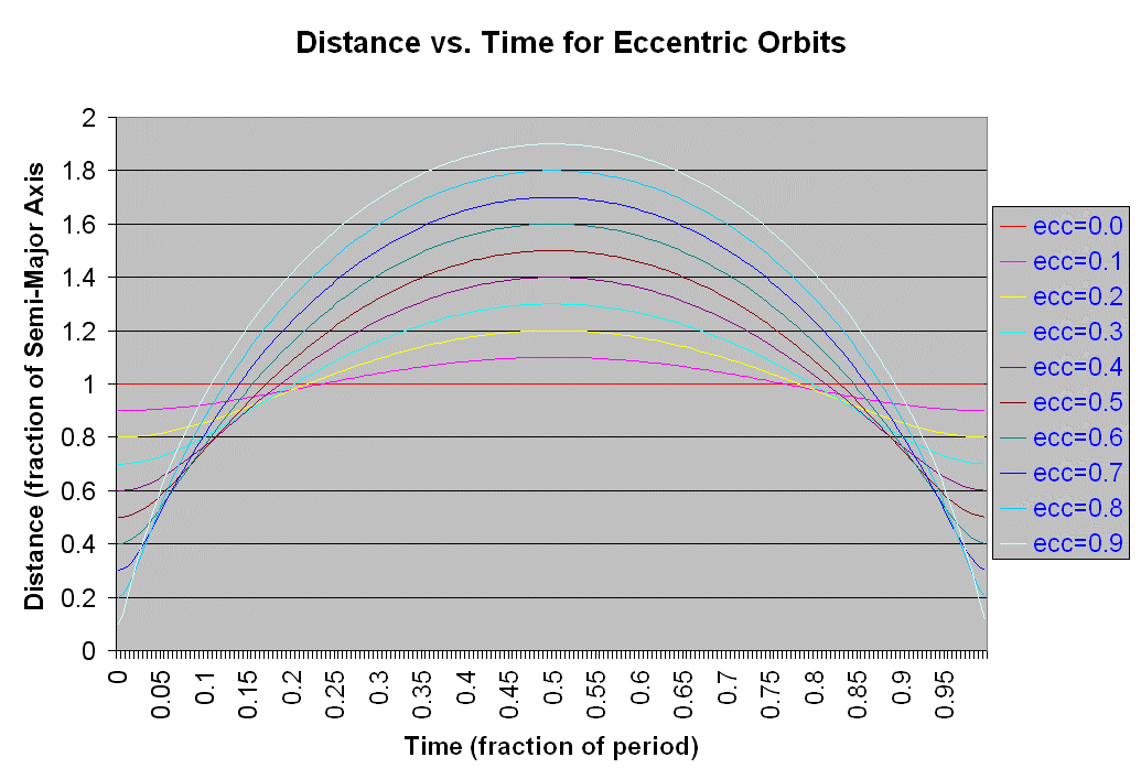

With no equation, you'll have to plot it using numerical methods. Here's my attempt. In Gravity Simulator, I created 10 planets with semi-major axes of 100,000,000 km from the Sun. This gives them a period of 200 days. I gave them eccentricities of 0.0 to 0.9. I then output their positions to Excel once a day for 200 days. I then computed their distances from their positions and plotted the results. Along the x-axis, time is expressed as a fraction of 200 days, so 1 means 200 days. Along the y-axis, I expressed distance is a fraction of semi-major axis, so 1 = 100,000,000 km. These 2 axes should scale to any planet at any distance.
http://orbitsimulator.com/BA/distanceVStime.GIF
Texas2011 said:
If I wanted to plot the distance as a function of time with t=0 being the closest the object would get, how would I do it?
If you have access to a spreadsheet or similar you can fairly easy make such a plot based on an approximation of the radius.
First you have mean anomaly
[tex]M = \frac{2 \pi T}{P}[/tex]
where T is the time since last periapsis passage and P is period, both values expressed in same time unit. From M you now have to solve Keplers equation to get eccentric anomaly E which relates to mean anomaly M as
[tex]M = E -e\sin E[/tex]
In a program you would normally solve this equation numerically by iteration until a desired accuracy is obtained. In a spreadsheet you can instead use a fixed approximation like (taken from [1])
[tex]E \approx M+\left(e-\frac{e^3}{8}\right)\sin M + \frac{1}{2}e^2 \sin 2M + \frac{3}{8}e^3 \sin 3M[/tex]
if eccentricity is not too large, or you can set up a fixed number of fast converging iterations, like using Newton's method (see for instance [2]) to get
[tex]E_{i+1} = E_i + \frac{M+e\sin E_i - E_i}{1-e\cos E_i}[/tex]
with all angles in radians and [itex]E_0 = M[/itex] for [itex]e < 0.8[/itex] and [itex]E_0 = \pi[/itex] otherwise. In a spreadsheet you can set up a fixed number of successive columns to calculate [itex]E_i[/itex] and then use the last approximation as E.
From eccentric anomaly E you can calculate the normalized radius as
[tex]\rho = \frac{r}{a} = 1 - e \cos E[/tex]
where a is the semi-major axis. In a spreadsheet you can now plot [itex]\rho[/itex] as a function of time or mean anomaly. Notice that I skipped calculating the so-called true anomaly and went straight to radius. The true anomaly would for instance be needed in addition to the radius if you wanted to plot the 2D position instead of only the radius.
As you can see, apart from finding a good approximation for E, the rest is rather simple. Feel free to ask if some of the above is too hazy for you.
