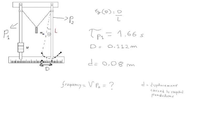

Coupled physical pendulums (URGENT)

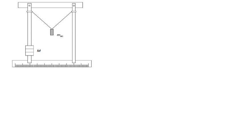

Imagine that you have coupled physical pendulums like this (see image below).
mass is in the inferior part of the pendulum.*
Now we let the right pendulum swing without initial speed = 0 with a certain amplitude. As we know, the amplitude of the right pendulum will decrease , increasing the amplitude of left pendulum.
I have the Period for the max amplitude of the right pendulum. When the amplitude of the right pendulum is zero, i have to mark the max amplitude of the left pendulum.
You can see in the following image:
L it's approximated 1 meter.
d its caused by the coupled pendulums. it's the distance between the equilibrium point without being coupled to the equilibrium point being coupled.
Now how can i calculate the frequency (v max) of the left pendulum??
I just know the period of the right pendulum. I know the max amplitude in left pendulum. How can i calculate the frequency of the left pendulum?
( frequency is induced by right pendulum)? I really need help, its urgent.
anyone??is something my problem that is not explicit?
TBH, I can't make head or tail of it.
The diagram looks like no coupled pendulum arrangement I've ever seen.
You seem to have a rigid bar on the right - which could be a pendulum except that it has no mass associated.
On the left is another bar, this time with a mass so I assume that IS a pendulum. And between them you have a mass suspended on a cord.
The nearest thing to this in standard physics texts is two pendula coupled by a spring. The analysis of the motion is not simple.
Try http://http://www.theorphys.science.ru.nl/people/fasolino/sub_java/pendula/doublependul-en.shtml
that link is not working. :/
i found this equations to coupled pendulums.
I= inertial
α and β are angles.
M1 = mass of right pendulum
L1 = length of right pendulum = L2
m2 = mass of left pendl..
For the right pendulum:
I1.d^2α/dt^2 = -1/2.M1.g.L1.sinα - k[sinα - sinβ]
For the left pendulum:
I2.d^2β/dt^2 = -1/2.m2.g.L2.sinβ k[sinα - sinβ]
in the limit of small angles
α,β << 1
so:
I1.d^2α/dt^2 = -1/2.M1.g.L1.α - k[α-β]
I2.d^2β/dt^2 = -1/2.m2.g.L2.β + k[α-β]
if we consider a weak coupled pendulum system, then:
k<<1
and because left pendulum have a mass and a inertia much greater then the right pendulum:
M1>>m2 and I1>>I2
Equation to right pendulum can be simplified to:
I1.d^2α/dt^2 ≈ -1/2.M1.g.L1.α
to left pendulum we have:
I2.d^2β/dt^2 = -[1/2.m2.g.L2.β+ kβ ] + kα
i.e
I2.d^2β/dt^2 + (ωo)^2.β = kα(t)
then
(ωo)^2 = 1/2 * (m2gL2) + k
so the frequency induced by the right pendulum to the left pendulum is:
f = 2.pi/ωo ...
is that right?
