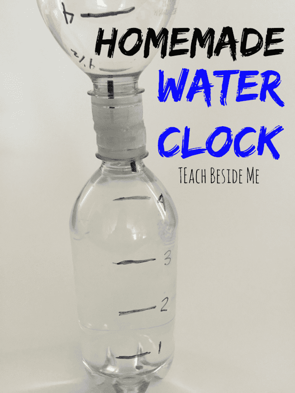

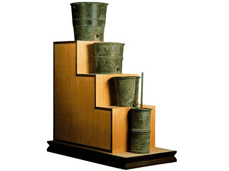

The cone was only one of many. Here's a simpler one.
And another.
