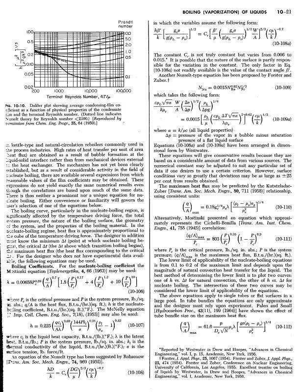

Here's a page on boiling heat transfer from Chemical Engineers Handbook, 5th Edition, by Perry and Chilton:
Scanned textbook page 10-21 titled BOILING (VAPORIZATION) OF LIQUIDS, with a log-log graph of Dukler plot condensing-film coefficient versus terminal Reynolds number, numbered equations 10-106 to 10-112, and text on boiling coefficients.
This edition has over 60 pages on heat transfer. The current edition is Perry's Chemical Engineer's Handbook, by Green and Southard: https://www.amazon.com/dp/0071834087/?tag=pfamazon01-20.
Have fun!
