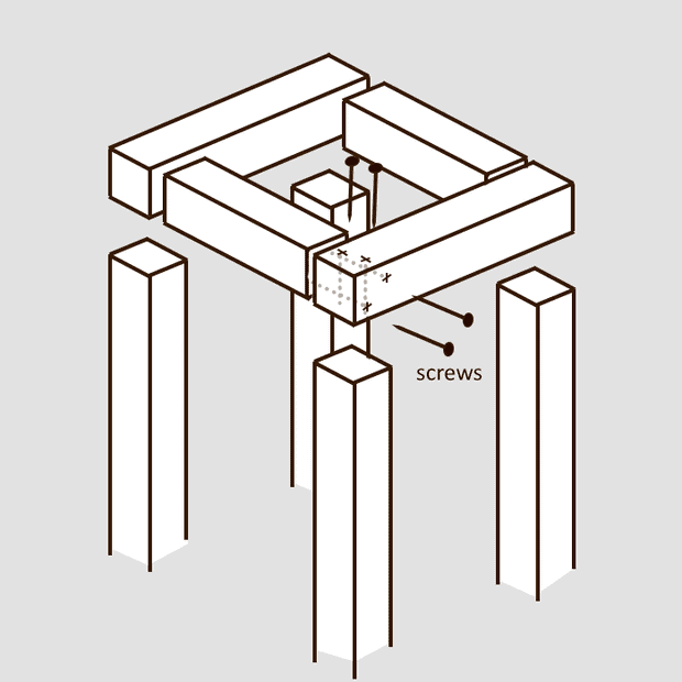

TL;DR Summary: How can I make these joints better?
I find myself making a lot of things that are open boxes - plant stands mostly.
Sometimes the wood is merely 3/4 x 3/4 nailing strips. I use deck screws to hold them together. In that case, I only use one screw, not two. (I predrill with a countersink bit or it will certainly split the wood.) Today, I made a few using 2/2s, so I used two screws, to ensure strong joints.
My trouble is, when I make a 3-way joint, the screws cross and I've busted a lot of drill bits. I try to stagger them but it's (literally) hit and miss.
Do woodworkers have a better - yet still economical - way to join these 3-way corners?
I know I could use strapping or angle brackets if I really wanted to sidestep the whole problem, but that's expensive and time-consuming. And I'm trying to make these fast, cheap and with a minimum of extra bits like brackets.

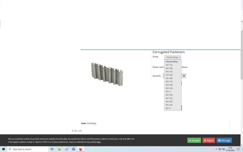

From experience, depends on tools. Joiner by trade so fully equipped workshop. Mortice and tenon would be a traditional way into leg but if this something of a hobby and knocked up in a shed then a mitre joint for 4 top rails, top frame, would be a choice. Mitre increases glue line area, a biscuit, as shown by others, aids location and assembly and that joint could be held by air nail/pin. If no air tools then ratchet straps work fine, though attention to keeping top fram square is a must. When I first started out, limited tools, I found "corrugated fasteners, 'dogs' or 'wriggly nails' across mitre very good and strong, angled so pulls up. Once top frame done I guess a screw down into leg would be ok, though I would prefer a fluted wooden dowel pin. Air nail / pins leave a tiny hole easily filled unlike a screw head. If you could standardise the stock then a jig would help. What machinery do you currently use

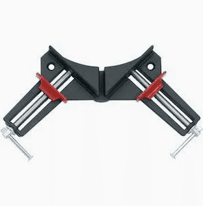

I try to use jigs when possible. For this, I have angle clamps.

Chop saw is handy, better still if it mitres. I too had those clamps, 4 number and just a nobex hand saw. 3/4 is tiny stock for a screw. I note your square end diagram, have you tried mitre joint?
Yes I hate mitre joints on corners. They never fit, especially at 3/4".
