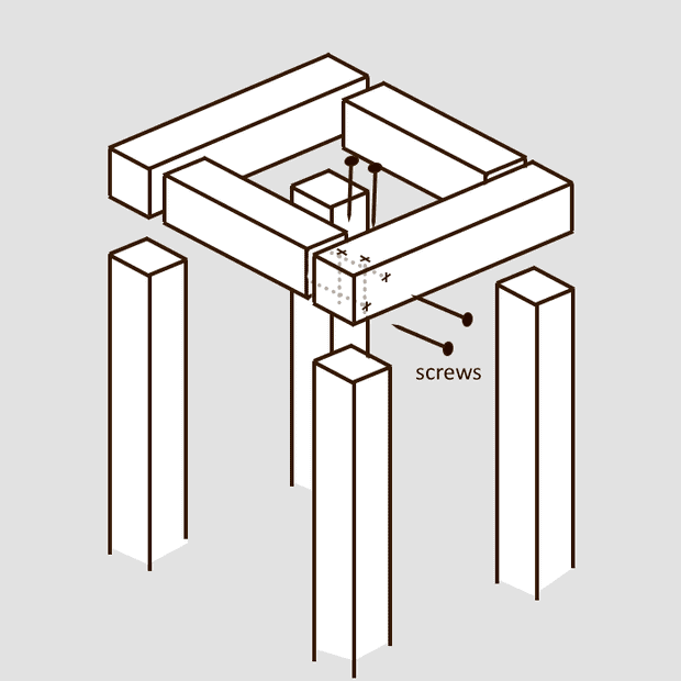

I find myself making a lot of things that are open boxes - plant stands mostly.
Sometimes the wood is merely 3/4 x 3/4 nailing strips. I use deck screws to hold them together. In that case, I only use one screw, not two. (I predrill with a countersink bit or it will certainly split the wood.) Today, I made a few using 2/2s, so I used two screws, to ensure strong joints.
My trouble is, when I make a 3-way joint, the screws cross and I've busted a lot of drill bits. I try to stagger them but it's (literally) hit and miss.
Do woodworkers have a better - yet still economical - way to join these 3-way corners?
I know I could use strapping or angle brackets if I really wanted to sidestep the whole problem, but that's expensive and time-consuming. And I'm trying to make these fast, cheap and with a minimum of extra bits like brackets.
I am seldom happy with screws into end grain.

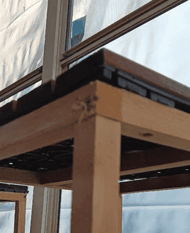

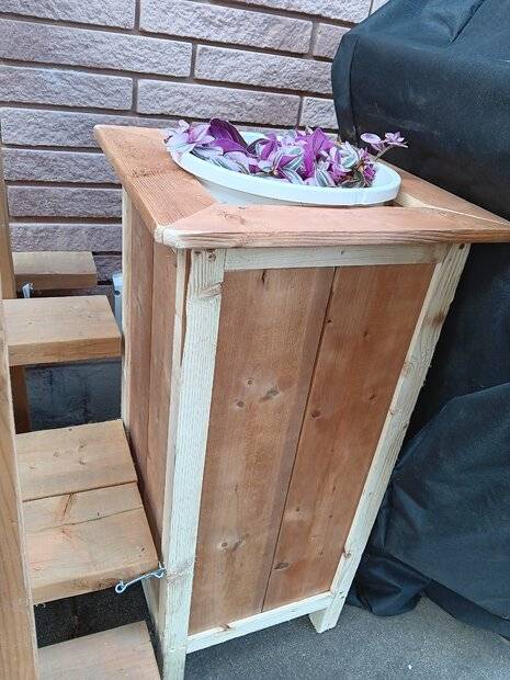

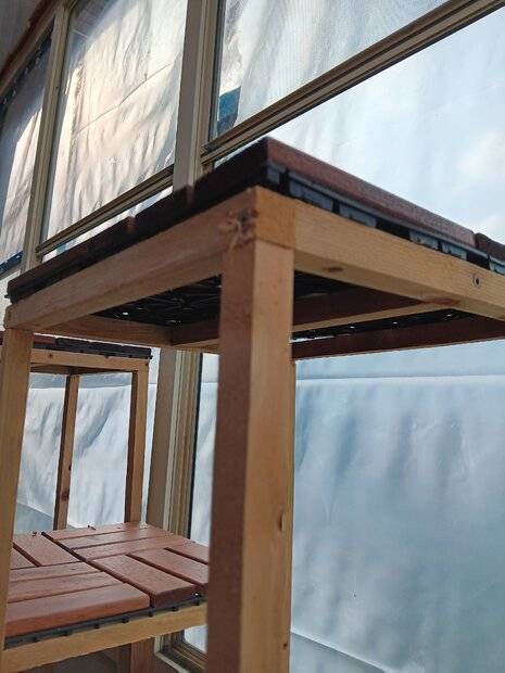

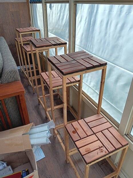

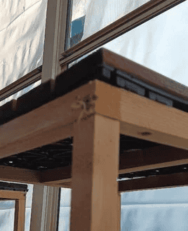

Indoor plant stands - 3/4"x3/4". These take me less than an hour to build.

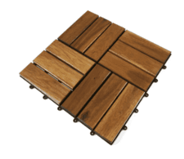

(Those tops are simply deck tiles, which cost less than 3 bucks each and come in packs of 10 :wink: )

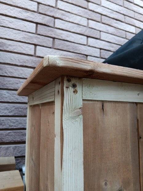

Outdoor planters 1½"x 1½". (With fence board panels) These took about 3 hours each.

Here is a 3/4" join:
And here is a 1½" join (you can see where I hit a cross-screw, snapped a drill bit and had to re-drill):

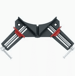

Can you set your chop saw at a 45 degree angle to angle these butt joints so both cross members are supported by the vertical member?

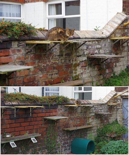

As a DIY cat-gym builder, may I compliment you on those 'lounging shelves' ? I've fitted garden wall with a dozen shelves of decking as square tiles or side-by-side grooved planks, allowing multiple route options...
FWIW, for 'rough' wood-working, I must highly recommend the mentioned 'cross-dowel' approach to end-grain. It prevents / stabilises cracking and splitting, can also salvage near-Gordian 'knotty' problems...
( An unwritten 'Murphy Law' corollary is that any batten set against brick wall will have a quorum of 'knots' clash with optimal fixing locations: I've become adept at recursively cross-drilling and gluing 8mm dowels... )
Yes. Although I don't see how that solves the problem. I'm not worried about supporting weight so much as making a solid joint that doesn't flex. And that change would still have two screws intersecting.

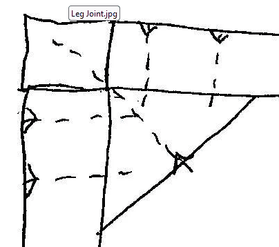

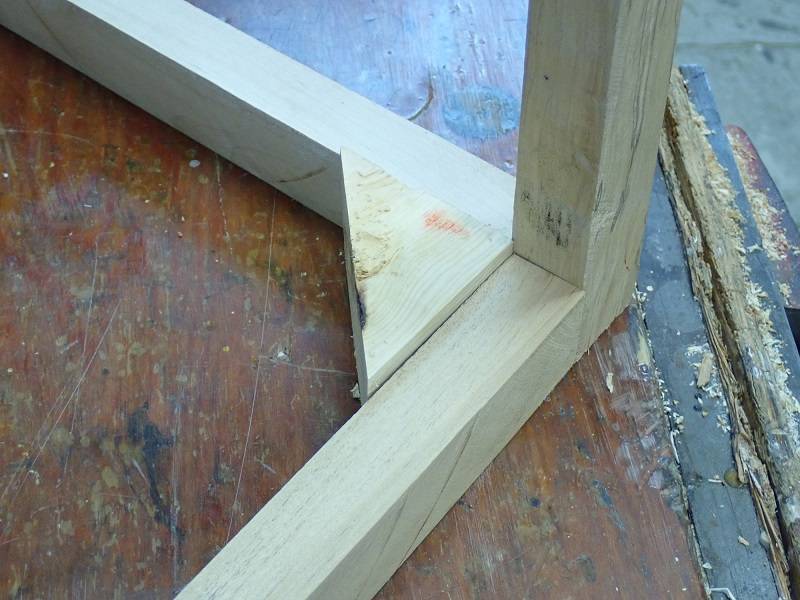

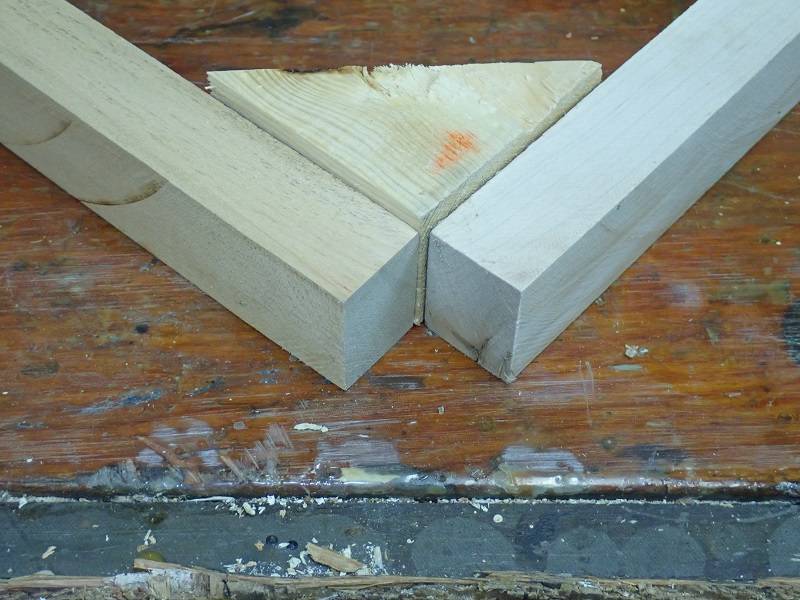

Here's an idea. Two screws from each cross piece into the triangle piece, plus one long deck screw through the triangle piece into the leg. And glue all joining surfaces. Everything is securely fastened, so there should be no wobbling even without the glue. The glue is then backup for the screws.
How are the crossmembers supported by the vertical leg in your sketch? Sorry if I'm missing the obvious.
Each crossmember is rigidly attached to the triangular piece by 2 or even 4 screws. The leg is pulled into the square corner formed by the ends of the crossmembers by a long screw through the triangular piece. Pulling into the corner locks the leg against wobbling, the screw locks it against sliding, which supports the table. If all mating surfaces are flat and square, the resulting joint is rigid. Gluing the joint is not necessary, but adds redundancy and helps prevent the screws from loosening.
As you know well, I'm a little slow. What is that center square in the sketch? Which crossmember does it belong to? It's the top of the vertical member, but is there overlap with one or two of the crossmembers?
If a picture is worth 1000 words, two pictures should be even better. Photo below shows the crossmembers and triangular piece without the leg:
Then the leg is added:
This is a two minute model slapped together from the scrap box. If I was doing it for real, the triangular piece would have the grain parallel to the 45 degree face (the long face) (the hypotenuse of the right triangle face).
So the vertical weight forces of the load on the platform will 100% be supported by the screws between the horizontal members and the vertical support? Why not push the horizontal members a bit onto the vertical support?
Yeah, maybe what I'll do is put a little 45 brace in there - not a big one like jrmichler suggests; I'll make it out of the same wood: so 3/4". And glue it and tack it with little brads. That's doesn't add too much material or time/effort.

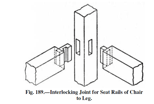

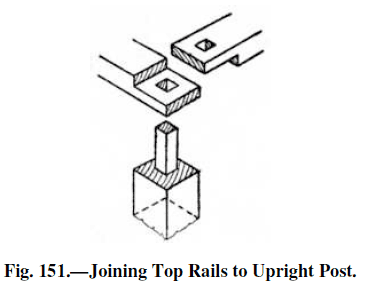

Yes, but it sounds like you want to take an easy route. Here are three traditional joints for your application, from Fairham, Woodwork Joints. I would hold them together with a water-resistant glue (Titebond III, e.g.).
As noted above, screwing into end grain doesn't hold very well. You can insert a crosswise dowel and screw into that for better holding power. I don't have a picture but this metal version gives you the idea:

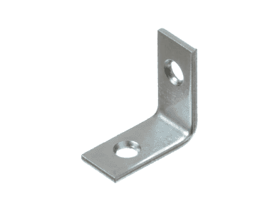

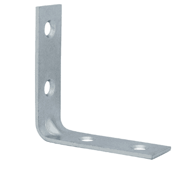

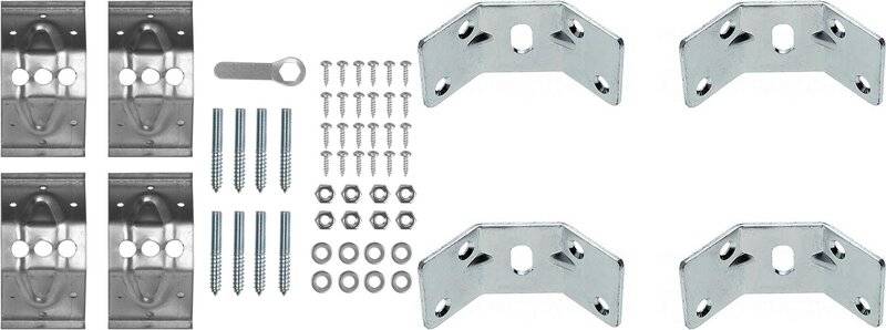

IIRC, the truncated right-angle of wood or metal through-fixed from hypotenuse to leg is one of the standard ways to craft a 'storable' table.
Here's pics of a complete kit and a 'roll your own'...
Here's pics of a complete kit and a 'roll your own'...View attachment 346544
Yes, if I were going to go this route, I'd stock up on these little guys:
but I'm trying to avoid such extra bits being added to the cost, weight and aesthetics.
