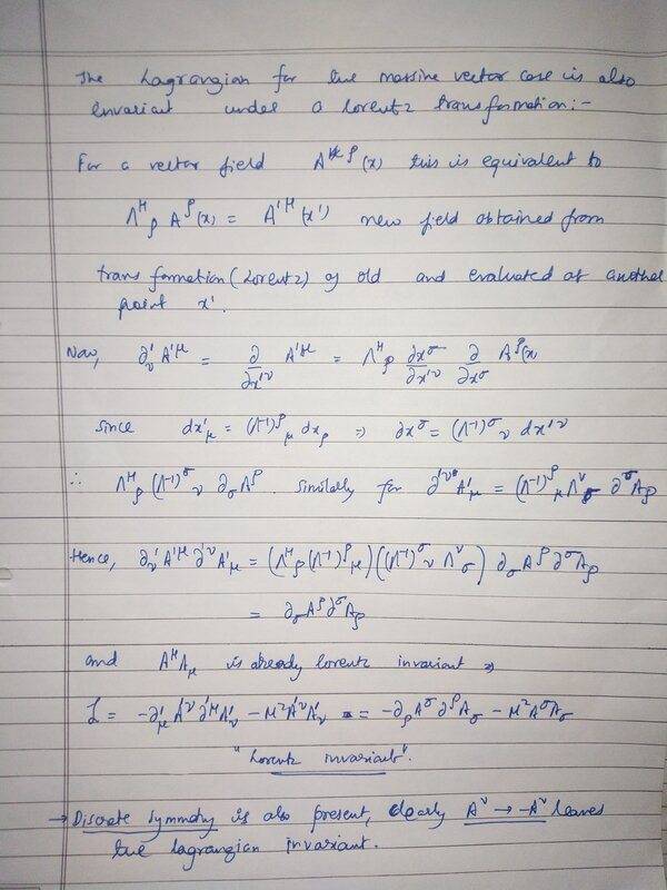

Handwritten derivation showing the Lagrangian for a massive vector field is invariant under a Lorentz transformation, with partial derivatives transformed via Lambda matrices and the result reduced to a Lorentz-invariant Lagrangian, followed by a note on discrete Z2 symmetry A to minus A.
@PeroK I was busy with other subjects so replied late 😅. I did try proving yesterday the invariance under lorentz transformation in this way, now that it's invariant i want to know the current due to lorentz symmetry but i don't know how to proceed for that. Is calculation till here sufficient to proceed for finding the conserved current ? Can anyone tell how should i proceed next ?
