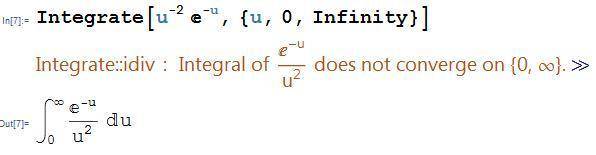

when i tried to solve it in Mathematica, it give me the following msg,
Mathematica session: input Integrate[u^-2 e^-u, {u, 0, Infinity}] with error message Integrate::idiv that the integral of e^-u/u^2 does not converge on {0, infinity}, followed by the output integral from 0 to infinity of e^-u/u^2 du.
I'll try explain what you got from the program:
in your question the integral is from u to infinity and you tried to calculate it in Mathematica as an integral from 0[/] to infinity.
your integral diverges i.e. the sum that the integral calculates goes to infinity near 0.
in other words it has a singularity there.
but if you can try to calculate in some ways, tell us in what course you got it (what tools you've learned) and may be we point you to the right way :)
*could be represented as a series and could be split into several parts one of one of them the integral is just the Exponential Integral or Ei...

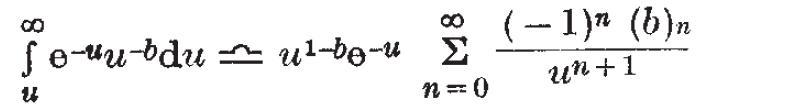

Then in a research paper I found a solution of this function,
Equation: integral from u to infinity of e^(-au) u^(-b) du, approximately equal to u^(1-b) e^(-u) times the sum from n=0 to infinity of (-1)^n (b)_n / u^(n+1).
The reference to about solution is "Rainville, E.D., Special Functions, 44 (Macmillan, 1960)."
And i don't have any access to that reference.
If i cannot justify the solution then it is hard to me to use it.
