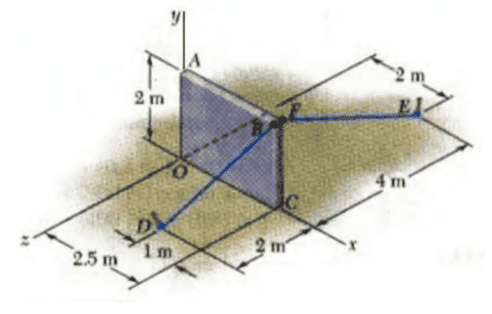

The Trump's wall is so weak that has to be supported by two cables as is shown in the figure. If the tension over the cables BD and FE are 900 N and 675 N respectively.
(I'LL UPLOAD AN IMAGE OF THE PROBLEM SO YOU CAN SEE IT)
τ = r χ F
Mo = r χ F
e= unitary vector
ra= 1.5i + 2j + 2k
ιeι= √1.5^2+2^2+2^2
ιeι= 3.20
e= 0.46i + 0.62j + 0.62k
F= 900(0.46i+0.62+0.62k)
F= 414i+558j+558k)
and by performing the determinant of the torque
T= r χ F
T= 9k - 9j
That's what I got by doing it but i don't really know if I'm okay. Hope someone can help me

GaussianSurface said:
the r what I got was 1.5i + 2j + 2 k
There is no ##\hat{k}## component for ##\mathbf{r}##.
and the force we know that in order to compute this is the module of F by the unitary vector ''e''
then F= ιFι e
I see. The unit vector ##\mathbf{e}## is not quite right. The ##\hat{i}## and ##\hat{j}## components should have the same magnitude but ##\hat{i}## needs to be negative.
Damn, then it'd be like this?
r = -1.5 i + 2 j ?
or
r = -2 i + 2 j ?
what i do not know is if I am going to substract the meter to the 2.5, please tell me if that is okay or what...
The components of ##\mathbf{r}## are composed of the distance in x and distance in y it takes to go from the point ##O## to the point ##B##.

##\mathbf{e}## points in the direction of the cable. So it will have all three components ##\hat{i}##, ##\hat{j}##, and ##\hat{k}##. To find ##\mathbf{e}##, find the vector that points from ##B## to ##D## then divide it by the length of the vector.
NFuller said:
##\mathbf{e}## points in the direction of the cable. So it will have all three components ##\hat{i}##, ##\hat{j}##, and ##\hat{k}##. To find ##\mathbf{e}##, find the vector that points from ##B## to ##D## then divide each compo
e= 1i - 2j + 4k ?
and the i divide
The vector pointing down the length of the cable is ##-1\hat{i}-2\hat{j}+2\hat{k}## now divide this vector by its length to get ##\mathbf{e}##.
e = -0.32i - 0.62j + 0.62k
Something is still not right. You need to divide by the length of the vector which is ##\sqrt{(-1)^{2}+(-2)^{2}+(2)^{2}}##.
Well, my teacher told me in order to find the module of it
You mean the module, right?
Well, my teacher told me to find the module so i can find the e
Yes, but you were finding e of the wrong vector. In post #10 you found the modulus of the r vector, which is not helpful. You want the unit vector in the direction of the force.
I see NFuller put you on the right track in post #11.
e= -1/√5 -2/√5+2/√5
I do not think you are using the terminology correctly, and the √5 is wrong.
Given a vector (-1,-2,2), its modulus (not module) is √((-1)2+(-2)2+22)=3. This is a scalar.
The e vector would mean the unit vector in the direction of the original vector, and that is obtained by dividing by the modulus, giving (-1/3,-2/3,2/3).
e= -1/√5 -2/√5+2/√5
You need to put the unit vectors in. The magnitude is not ##\sqrt{5}## it is 3 as haruspex said.
