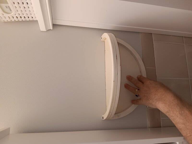

Made of finish-grade ply, want to spray it white, but I'd like a smooth surface
Just made a little shelf for the bathroom. It's made of finish-grade plywood. If I just spray it, it will look like spray-painted wood. (I'd usually just use Tremclad gloss white). Can I put some sort of sealant coat on it so the spray coat is smooth? Do I put a top coat of shiny on it afterward?
Everything else in the bathroom is standard IKEA-esque white veneer.

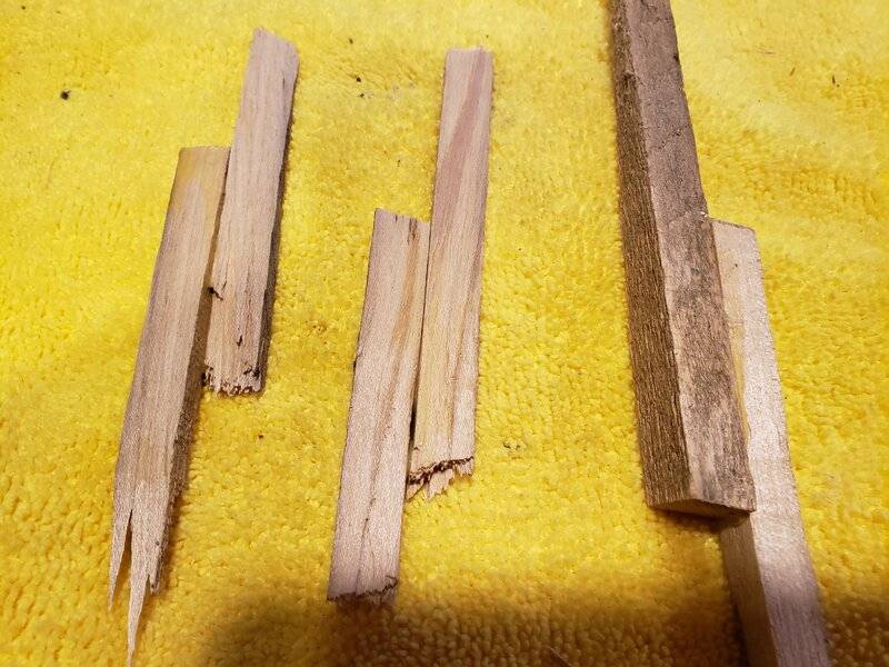

I did an experiment with some Titebond wood glue that is probable the better part of 10 years old. Pieces of wood were glued together and at the same time a small sample of glue was wrapped in Saran wrap and frozen for about 24 hours. The frozen glue was then thawed and two more pieces of wood glued together. 10 hours latter I tried breaking the glued wood pieces apart at the joints. In all cases the glued joints were stronger than the wood, the glued joints did not come apart. So one freeze cycle did not seem to ruin the glue but keep in a shed over many freeze thaw cycles probably needs to be in a land fill.
Thanks for this. I warmed the glue over my space heater until it was liquid and then mixed in some water. Seemed to work OK.

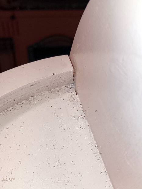

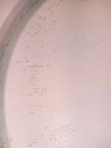

I've added a few coats of spraypaint*, sanding in between. It was coming along OK, but this last coat went awry. As it dried, it started to wrinkle up. When I went to sand it, the wrinkles ripped off, and now the finish is ruined.
*which turned to be more off an off-white in the pink range - not a tragedy since my bathroom has a bit of a pink tinge to it.
You can see here that when I went to sand down the wrinkles, they came off right down to the wood:
I have a few theories why this happened:
  • I did not prime or seal the wood before starting. Maybe I should have. Although the paint does say no priming necessary.
  • Maybe I should have used a paint that's specific for wood. This is what I used:
    Altough it does say it's usable for wood.
  • I picked up the can in a hobby surplus shop in a discount bin. It could be years old. The batch# on the bottom says 423220001 HL2208PB NFP 1.40 00:04. No idea if there's a year encoded in there.
  • The sandpaper I'm using is 600grit, wet. (I'm not using it wet.) Maybe it's a little too fine.
  • Maybe I am not letting everything dry sufficiently - be it paint or glue. Exacerbated by the low temps when I have it in the shed, resulting in longer drying times. (though I do bring it in overnight to dry.)
  • I have been bringing the work (and the paint and the glue) between warm house and freezing shed. I wonder if what's happening is that the moisture in the wood or in the glue (which ought to be dry) is leeching out of the wood and freezing under the paint.
Regardless, I think I'm going to regelate this attempt to "prototype" status and start again with what I've learned.
This is a piece that I - and everyone else - are going to see every single day close up, since it's at eye-level right next to the sink. So I'm trying to do this to a standard higher than my usual "rough nailing strips and deck crews" work.
Besides, I'm not happy with other aspects, for example: the joints. You can see where I didn't join it very well with a screw because I was afraid it would split the plywood - even though I pre-drilled it. That'll be really obvious.
Also, I missed with the nail gun along the straight edge - that ply is only 1/4" thick.
Luckily, I have a second clock face blank, so it's no loss to start again. This time I'll do a proper job sanding before I assemble it, and follow whatever advice you guys offer about the paint job.
And maybe I'll use actual white paint this time.
Looks like the spray paint worked OK on the vertically oriented piece of wood in the picture. The surface with the imperfections is hidden, ignore?

Sorry, you're looking at it lying down. That "vertically-oriented" surface you're seeing is actually the underside of the shelf.
No, the flawed surface is front-facing, under the shelf - where my hand is. Pretty obvious. The crummy joint is in the upper left - also pretty obvious.
This the correct orientation.
