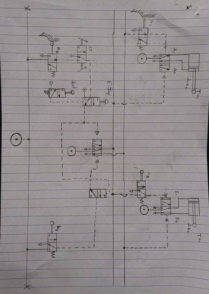

Keeeen Messages 23 Reaction score 0 Thread starter May 16, 2018 #1 This pneumatic circuit currently operates both of the cylinders automatically when the start valve is actuated. I want to modify the circuit so it will fail safe and park both the cylinders in the retracted position Attachments DSC_0469~2.JPG 33.6 KB · Views: 840
DaveC426913 Gold Member 2025 Award Messages 24,737 Reaction score 9,164 May 16, 2018 #2 What is your attempt at a solution?
JBA Science Advisor Gold Member Messages 1,532 Reaction score 462 May 16, 2018 #3 What type of failure(s) are you addressing, i.e. supply power loss or other?
