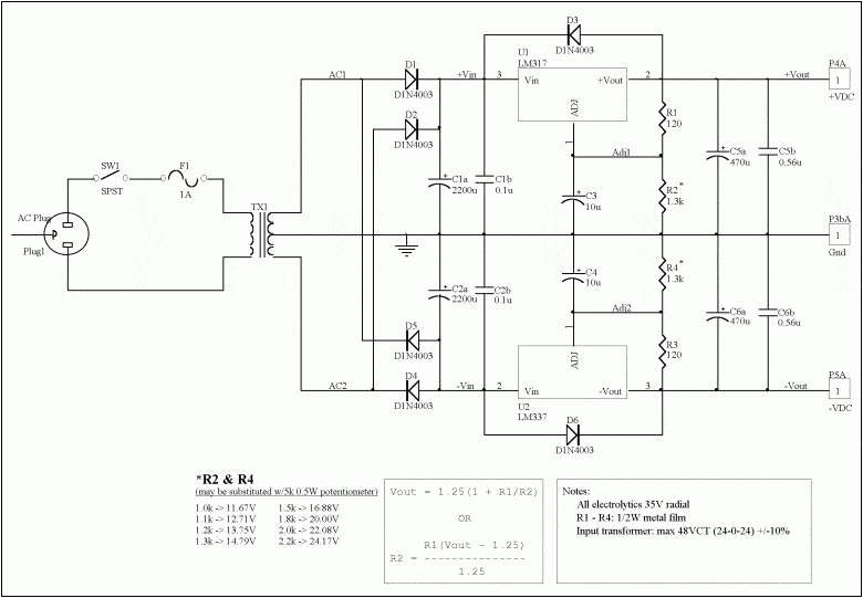

So many moons ago I made myself a pretty bog standard dual linear bench power supply using an LM317 and LM337 to give me -15 - 0 - +15.
In an attempt to get more current out of it (for no real reason other than because I can) I got a larger transformer and a beefier rectifier, then using the ever faithful 2N3055 and a pretty standard schematic managed to get a good 5amps out of the positive rail.
However modifying the negative rail has pushed my googling skills to the limit, and I'm at a loss as to how to go about modifying the existing LM337 circuit to also boost the final current output.
Any advise or suggestions on where to look would be greatly appreciated.
P.S.
Attached images are more or less what I'm referring to, the first pretty much being what I had, and the second, what I've achieved, on the positive side anyway...
Circuit schematic of a dual-rail linear bench power supply with LM317 and LM337 regulators, bridge rectifier, filter capacitors, and +VDC, Gnd and -VDC outputs.

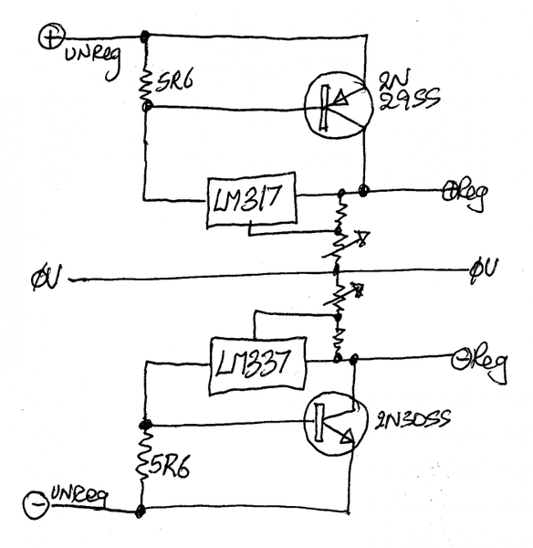

Schematic of an adjustable power supply: 24 VAC transformer L1, bridge rectifier D1, 2200uF input capacitor, LM317 regulator, 2N3055 pass transistor, R1 180 ohm, R2 5K potentiometer, 47uF output capacitor, titled 2-30 Volt Adjustable Power Supply.
Here is a quick concept design that uses a 2N3055 with the LM337.
Hand-drawn schematic of a dual-polarity linear power supply: a LM317 regulator drives a 2N2955 pass transistor on the positive rail and a LM337 drives a 2N3055 on the negative rail, with 5R6 resistors, UNReg inputs and Oreg outputs, and a shared 0V midpoint.
i like the simplicity and parts count !
Collector output on pass transistor may be sensitive to capacitive loading, so use plenty.
