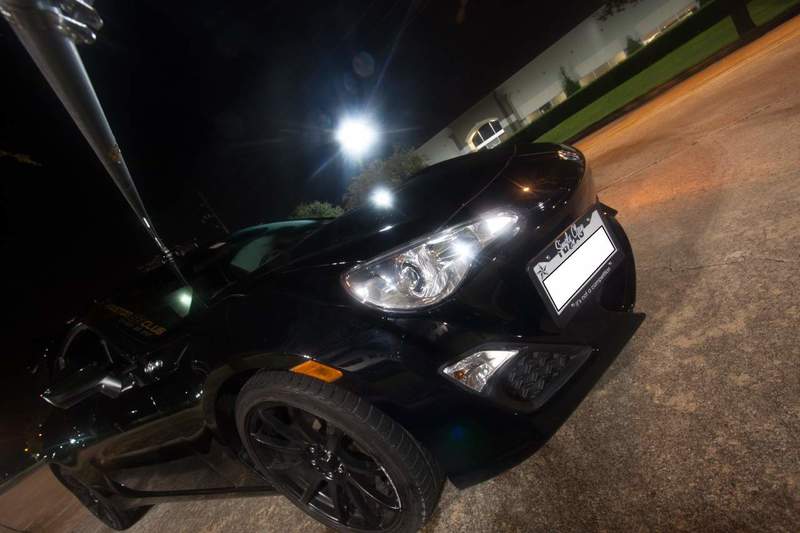

i have a what essentially can be explained as a lever and I'm trying to prevent it from flexing/bouncing when the car is in motion (i'm only going ~5mph, probably less)
the lever is a 10 ft steel conduit. 1" in diameter.
the "fulcrum" if you can call them that are essentially 3 ft apart, on one end of the conduit
and a load(Canon 40D) hanging from the other end of the conduit, less than 6 inches from the end
thank you in advanced

Welcome to PF;
Camera mounts on cars have to be much more sophisticated to get a steady pic.
To avoid excessive flexing, you need to use a stiffer beam - it is that simple.
You could stiffen the beam by adding bracing of some kind.
You will still get vibrations from the car though.
maybe prevent was the wrong word. i would like to minimize the flex as much as possible without it being bulky/heavy. i tried using some sort of suspension with a post above the camera connecting to the pole near the center with braided steel? cable.
That is indeed one way to do it:
http://www.faulhaber.com/Bilddatenbank/Applications/format1/fau_appl_fussball3.jpg
Another way would be to increase the diameter of the pole or use a beam with a higher moment of inertial. Regardless of the approach, you need more stiffness.
Nice picture of the car. Not a lot of detail shown for the camera support, though, which makes it kinda tough to see what you've done.
