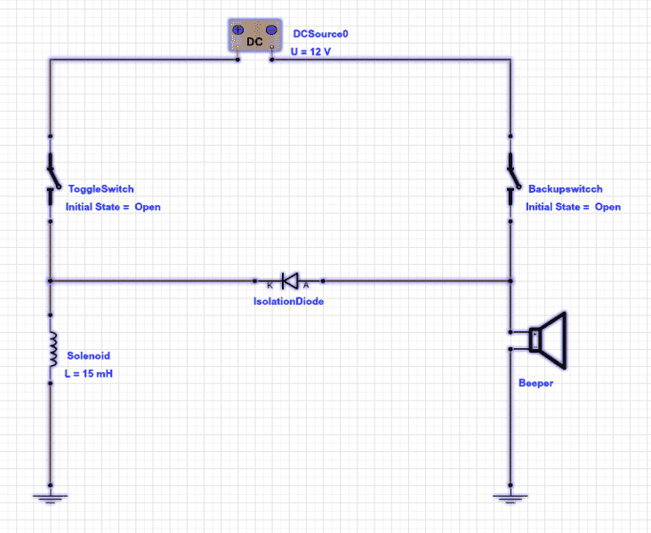

Here's what I am trying to do. I have a quad axle dump truck, I'm trying to have the drop axles automatically come up when put into reverse. The drops are raised and lowered via 2, 12 volt solenoid valves. I currently have the solenoids 'powered' to lift them and when they are lowered, the current is removed via 2 toggle switches in the cab of the truck. I ran a wire from the back up beeper to one of the solenoids and it now activates the solenoid and lifts the axle when the truck is shifted into reverse, but when I power the solenoid in the cab to raise the drop axles when empty, the back up beeper is being powered and always is beeping.
I am thinking I need some sort of diode with one lead in and two out, so no power goes to the back up beeper, so I can run one to each solenoid lift valve, but not sure. What do i need to fix this problem? Thanks in advance.
Yes - you connected it that way. Sit down and create a truth table with inputs "backup beeper power" and "solenoid power"; outputs "backup beeper sound" and "raise drop axles". That will give you the start of a solution.
It has to be connected that way, but what I need is a way to stop the back bleed of power from the 2, 12 volt solenoid to the back up beeper.
This should do it. Just make sure you install the diode the correct way around.
Oh and please disregard the battery symbol at the top. That should just be two +12V fuse taps and not a battery with + and - I didn’t see that when I grabbed the symbol and dragged it into the schematic. I guess I need glasses.
Right. So your solenoids can be operated either directly by a switch or as a consequence of selecting reverse - i.e by two independent switches.
All you need is for a diode in the connection between the vehicle electrics and the solenoids, letting current flow through the solenoid when the reversing beeper etc are activated but blocking current from the 'extra' switch to the beeper circuit so that only the solenoid is activated by your switch. You need the 'arrow' on the diode to point towards the solenoid in the circuit. If that verbal description is not enough then I'll need to draw a diagram but it's pretty simple.

Tom_K said:
This should do it. Just make sure you install the diode the correct way around.Oh and please disregard the battery symbol at the top. That should just be two +12V fuse taps and not a battery with + and - I didn’t see that when I grabbed the symbol and dragged it into the schematic. I guess I need glasses.
Yes Tom, that is how it needs/is connected, thank you for the diagram! Now, what isolation diode would you recommend?

Reverse breakdown is no problem for any rectifier diode you can find. (>12V) Forward current to drive a beeper and lamp(?) need only be a few Amps or so. Very easy requirements that many diodes will satisfy. No need to go chasing a specific device number. Anything in an eBay supplier's catalogue to suit.

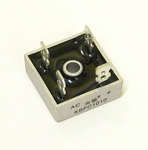

I looked, most seem to be something for a circuit board. I need something with coated wire leads, as this goes under the truck cab and will be exposed to the elements to a certain degree. I'll use heat shrink butt connectors to connect. Thank you.
The diode will also need to handle the solenoid current. Nothing special a run-of-the-mill generic blocking diode with enough current rating to handle the solenoid current. This ebay page has a big selection of them. You just need to know what current the solenoids draw. Check the size of the fuse in the solenoid circuit and get a diode with the same rating or a bit higher so the fuse will blow before the diode pops.

I just looked again and to me they looked like they are all soldering types for a circuit board. Of the few that might work, are 3 phase. Thank you.
You can solder leads on to it and heat shrink the whole thing can't you? I've done it before.
I suppose so, but then I would need to make some sort of enclosure to keep it isolated. I was hoping to be able to use one that was enclosed already that had plugs on it or wire leads.
Put some long leads on it, heat shrink over it and ty-rap it up inside the engine compartment where it will be safe and dry. You ought to see what my old car looks like!
Do you know the resistance of that solenoid? How much current it draws ? Same for the beeper?
When you turn off the solenoid its inductive "kick" will try to pull current through the diode and beeper.
If solenoid's current is much more than beeper expects, it may wreck Mr Beeper.
A diode across Mr Solenoid would be a good idea. If solenoid current is an amp or less, ie Rsolenoid >12 ohms, the 1N4000 series 1 amp diodes are cheap and available most everywhere.
I can't imagine solenoid requiring more than 5 amps, at that current it'd get really hot. Look for 6 amp rectifiers in a blister pack at electronics shop. Or pillage from a dead PC power supply.

@sedgehammer get one of these, 10A 50V are real cheap.
In TomK's post #8, use it in place of the diode...
tie the two AC terminals together and run to beeper
run the + terminal to junction of solenoid-toggle swtch
tie - terminal to vehicle's ground.
That'll do both jobs, steering current and suppressing inductive kick.
And it's easy to mount where you can see it.

Yes, that looks like I was looking for. Where can I buy it? Thank you!

Get some push on terminals and heatshrink while you're at it, to spread out that shipping cost
be aware they come in different widths, 1/4 inch most common
http://www.mpja.com/Quick-Connect-Terminal-Female-Blue-for-14-16AWG-250in-25Pcs/productinfo/18824 TM
same as this bridge
http://www.mpja.com/25A-100V-Bridge-Rectifier-IR-26MB10A/productinfo/30339 BR/
you don't need much voltage, 100 is plenty
