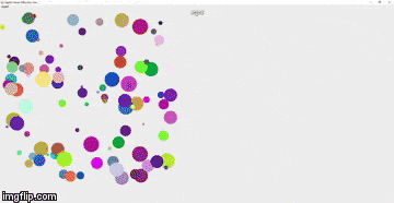

Hello,
I have this program where you run the JApplet and it makes circles at random. When you click the "Generate" button, it makes another set of random circles. The problem is, it overlaps the previous set of circles. I want the program to get rid of the previous set and I can't figure out how to do it. Thank you for your help.

You need to put something in your paint method to clear out the previous data. I don't have the method at the top of my head but something like a clear method on g.
I've looked around online and come across this, would I use this? I would need to manipulate it, but I just wanted to know if you're referring to this.
Java:
public void clear(Graphics g)
        // if(!clear)return; // optional
        g.setColor(getBackground());
        g.fillRect(0,0,(int)this.getWidth(),(int)this.getHeight());
        clear=true;
Thank you! I needed to add super.paint(g) in the paint method. This helped!
