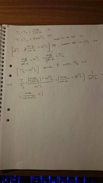

Hi,
I have two equations and two unknowns which I need to get the relation T1/T2 from.
The first one is ##T1-T2=(mg)/(cos(a))##
and the second one: ##T1+T2=mw^2L##
I need to solve for both T1 and T2. And if I add the bottom one to the upper I should eliminate T2.
But what happens with the right hand side? Is T1 simply ##1/2(mg)/(cos(a))+mw^2L##?
I can back off one step if I did anything wrong to this point.
The two equations one step back were: ##T1cos(a)-T2cos(a)=mg## and ##T1sin(a)+T2sin(a)=mw^2Lsin(a)##
Please help me, I need help with this!

I made one more try on it with algebra, I'll attach a photo. Did I get it right this time?
Edit: Oh dear, the downscaling of the picture. Here it is in a readable size. http://imgur.com/ngc8e9d

No... the method looks good, but line 3 is wrong.
How did you end up with two mg/cos when you only started with one?
It should read, $$2T_1= \frac{mg}{\cos a}+ m\omega^2L $$ Those equations look odd to me... do the units match up?
Looks like the 2am effect, get some rest.

Yes I see now that I forgot to divide the whole thing with two. And I have no idea what happened with the m...
But I tried to to it even more thoroughly again. I guess I can factor out the m and place before the parenthesis. Picture: http://imgur.com/2saPhqd

You subbed the result back into the 1st rquation?
Consider...
T1-T2=F
T1+T2=G
T1=( F+G)/2
T2=( G-F)/2
T1/T2 = ( G+F)/(G-F)
But Id definitely check the units if I were you.
