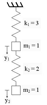

Determine the motion of this mechanical system satisfying the initial conditions :-
y1(0) = 1
y2(0) = 2
y1'(0) = -2*sqrt(6)
y2'(0) = sqrt(6)
Hint : there are 4 different methods you can use to solve this problem. They all give the same exact result.
I need to know what y1(t) and y2(t) are, please

I am not familiar with Laplace. Are you? Here is my idea...
Upper mass:
Upper mass, upward spring force -> -k1*y1 = -3*y1
upper mass, downward spring force -> k2*(y2-y1) = 2*(y2-y1)
the change in length of the upper spring is y1, and in the lower spring is y2 - y1
Eq1 --> y1" = -5*y1 + 2*y2
Eq2 --> y2" = 2*y1 - 2*y2

I am sorry, somehow I missed your previous message. Your method is essentially correct, but you forget there is also gravity.
I am told gravity pulls on the weights to start the springs moving, but you don't need to deal with gravity in the calculations.
Do you mean that ##y_1## and ##y_2## are measured from the equilibrium condition?
ideal springs, point masses cannot collide, y1 and y2 are the distances of the bottom end of the springs from the top, so that the length of the second spring is y2-y1. As for gravitational effects, gravity pulls on the weights to start the springs moving, but you don't need to deal with gravity in your calculations.
This statement: "gravity pulls on the weights to start the springs moving, but you don't need to deal with gravity in your calculations" does not make a whole lot of sense. Still, if you are told to ignore gravity, then you all you need to do is solve your equations.

Since you already know that the system will be undergoing harmonic motion, you can let ##y_1 = a \sin \omega t, y_2 = b \sin \omega t ##, and solve for ##a##, ##b## and ##\omega##. There will be two values for ##\omega##, and for each one, a pair of ##a## and ##b##. So you will have $$ (y_1^{(1)}, y_2^{(1)}) = (a_1 \sin \omega_1 t, b_1 \sin \omega_1 t) $$ and $$ (y_1^{(2)}, y_2^{(2)}) = (a_2 \sin \omega_2 t, b_2 \sin \omega_2 t) $$ The general solution is then $$ A (y_1^{(1)}, y_2^{(1)}) + B (y_1^{(2)}, y_2^{(2)}) $$
The only question remaining is how the heck do I solve for a, b, w1 and w2?
You should obtain a system of to equations linear in ##a## and ##b##. Two coefficients of the linear system will depend on ##\omega^2##. The system will have the trivial solution ##a = b = 0##. You need to find a non-trivial solution. For that, you must equate the determinant of the system with zero, that will give you an equation for ##\omega^2##. Solve it, you will end up with two values for ##\omega^2##. Then substitute each one into the system and obtain ##a## and ##b##.
A(y(1)1,y(1)2)+B(y(2)1,y(2)2) is what we have...so a and b must equal 0? I should be able to plug ANY numbers into each a and b and be able to have them equal correct? Or is there a correct way to do this...?
