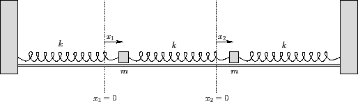

How can I uncouple this system when m1 ≠ m2? ....
  • Thread starter Thread starter juan carlos trujillo
    System
The discussion revolves around a system of coupled oscillators with unequal masses (m1 ≠ m2). The original poster is attempting to find a way to uncouple the equations governing the motion of the system, which is presented in a specific mathematical form. Participants are exploring various methods to achieve this uncoupling.
  • Some participants suggest using a general linear approach involving a combination of the displacements of the masses. Others mention the use of Fourier transforms as a potential method for solving the problem. The original poster expresses uncertainty about these methods and their application.
The discussion is ongoing, with participants providing various approaches and insights. There is an acknowledgment that the sum and difference techniques previously attempted by the original poster do not lead to a solution. Some guidance has been offered regarding the formulation of the equations and the potential for simplification through specific substitutions.
Participants note the challenge posed by the unequal masses in the system, which complicates the uncoupling process. The original poster has indicated a lack of familiarity with certain equations and methods suggested in the discussion.
HW Template missing as it was moved from another forum
this is the exercise :
i've got by modes:
https://scontent.fbog2-1.fna.fbcdn.net/v/t35.0-12/15311417_1271935189529554_1902854011_o.jpg?oh=09710fddf04ae58a465238d8f1786189&oe=58424904
but i can't uncouple it.
this is supposed to in the form x = -w2 *x i would like if you can help me to solve this problem.
