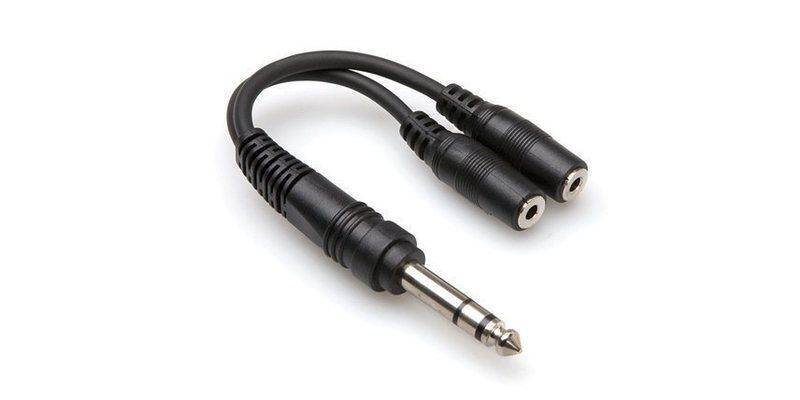

I want to purchase the Logitech z623 and add to it two creative inspire M2600 speakers (only the speakers, not the sub-woofer). The reason for doing this is because the Logitech system sounds really nice, it has an amazing bass, but mids and highs are not the best and I wish they was as clear as the creative speakers. I was looking for a process in which I would have to splice the creative speaker wires and attached them to the Logitech speakers. I am looking for advice on how to achieve this and perhaps it may not be convenient but I would like to hear your advice/feedback, thank you!
Rather than splicing wires, you might just plug a 3.5 mm splitter into the audio jack on your computer:

Probably the best you will get is a splitter to drive both systems, and go into the logitech and disconnect the speakers.

thank you everybody for your input. fzero, indeed that seems to be the best option. svein, I didn't think of that before, but it seems to be a good idea as well, thanks!
