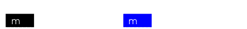

physea said:
I read that kinetic energy may not be preserved, but momentum must always be preserved.
How can that be?

Think about a collision between two identical objects that stick together, one starting stationary. The final speed is half the initial speed of the first object, momentum is conserved and energy is lost. The math to demonstrate this is straightforward...
[Edit...someone posted an animation of this...]
