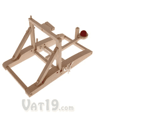

I take it you want to design something like in the picture to defend yourself or for an assignment. Start with drawing a few diagrams (##\phi = 0, t=0## then ## \phi = 125, t = ... \ ## See how gravity comes in, etc.
