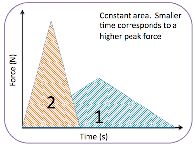

haruspex said:
True, but as I hinted, the average force is not the critical aspect.
Yes, but if Δp (assumed fixed) is spread over a longer time interval would that not mean that the instantaneous force dp/dt will be reduced (hopefully) below the breaking force for any time within the interval? Doesn't reducing the time-averaged force imply reducing the instantaneous force at all times during contact?
I don't see how that follows.

DaveC426913 said:
1N over 99ms followed by 99N over 1ms is an average of a mere 1.0N per ms.
The average would be 1.98N. (Not N/ms, which is not a dimension I've ever come across.)

The figure shows schematically what I mean. Collision forces in nature usually start from zero, reach a maximum and then go back to zero. Your example is that of a force that is constant for most o the duration then spikes to a large value. If you spread out the collision duration, you bring down the peak force. If the peak force is below the threshold breaking force of the shell, the egg does not break.
Yes, you are assuming the same overall shape stretched over a longer period. But one can do even better by changing the profile to a rectangle (over the same period).
