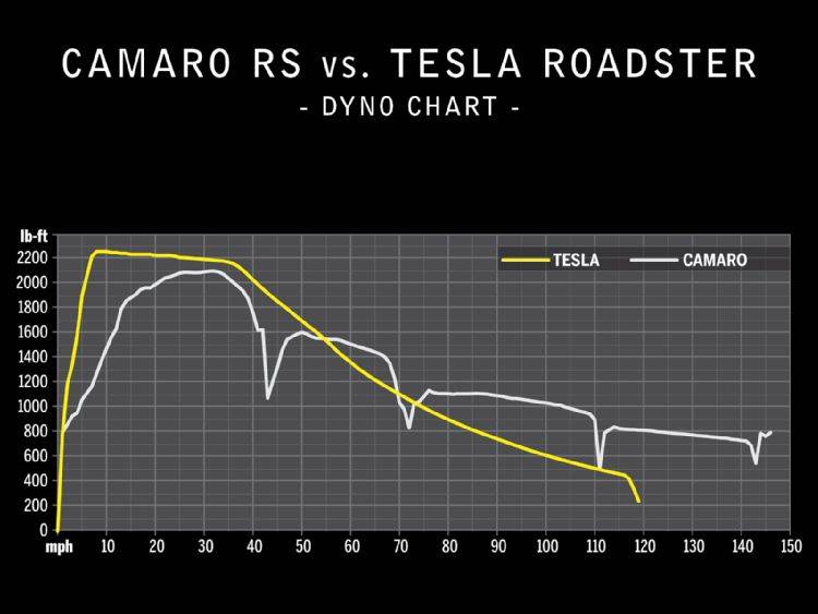

By construction, the power output of an ideal internal combustion engine (ICE) is proportional to its rpm. The cylinders pulls in the same quantity of air-fuel mixture for every revolution. Therefore, the torque is constant throughout the rpm range and the power input variation (i.e. the mass flow rate of air-fuel mixture) depends only on the number of revolutions per minute.
On the other hand, the power input of an ideal electric motor is proportional to its voltage and current input. It is independent of the motor rpm. And since torque is power divided by rpm, you can ideally get any torque value at any rpm. The only limit is how much power the motor can support before breaking up.
To get that high power in an ICE, you need to keep the engine rpm where it produces its most power by constantly adjusting (with a gearbox) the wheel rpm with respect to the engine rpm.
You could theoretically make an ideal ICE with rpm-independent power characteristics by deliberately cramming more air-fuel mixture in the cylinder at low rpm (i.e. keeping the same mass flow rate as when in high rpm, therefore creating a 'constant power' engine). Technically, this means using a very large engine that would be underused at high rpm.
I found this image online that might help visualized the concept:
The downward part of the yellow curve represents more or less a 'constant power' curve, i.e. the maximum power the Tesla electrical system can support. The flat portion is limited by design to match the traction limit of the tires.
With the white curve, the first gear is designed such that the peak torque matches the traction limit of the tires, and the last gear is designed to match the desired maximum speed. Then other gears are inserted in between to maintain the engine as close as possible to its maximum power, therefore simulating a 'constant power' curve (i.e. torque decreasing as speed increases).
Shouldn't the torque go to zero during gear changes in that diagram?
Well, technically, you are not accelerating when shifting so your speed stays constant. You should then see the value at that speed to be the maximum possible value. Although not ideal, it may also be different from one gear compared to the other.
