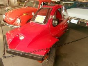

In the late 1970's a guy in Burnsville Minnesota built such a car as you describe.
He used a single rear wheel for simplicity. That also let owners in many states register it as a motor-driven cycle which was cheaper.
His drive train was a one cylinder aircooled Tecumseh engine with variable sheave pulleys for infinitely variable transmission. Nowadays there's a lot of those around surplus thanks to snowmobiles and ATV's. He offered a diesel but it wasn't cost effective given the gas version delivered 100mpg.
I saw one once in Miami - but down there with no airconditioning they didnt catch on.

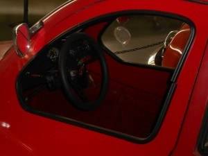

The HMV Free-Way Micro Car
Tough times often produce alternative ideas. One answer to high gas prices came from Minnesota and in the form of a 3 wheel car. A Burnville Minnesota car manufacturer answered the 1970′s high gas prices with the introduction of what was called the “micro car”. The inventor of the HMV was Dave Edmonson. Edmonson believed he could build a small car with superior gas mileage and he actually started his project back in 1970. The micro car was called the HMV Free-Way Car. This one seat, three wheel, extremely small vehicle was powered by either a 12 HP or 16 HP engine. It’s manufacturer, the H-M-Vehicles, Inc, boasted a 100 MPG rating for the 12 HP engine and about 60 MPG for the 16 HP model.
hmv cars
The HMV 3 wheel cars were built from 1979 to 1982.
courtesy http://automuseumonline.com/auto-freeway-cars-1981-hmv.html
see also http://clubs.hemmings.com/hmvfreeway/
