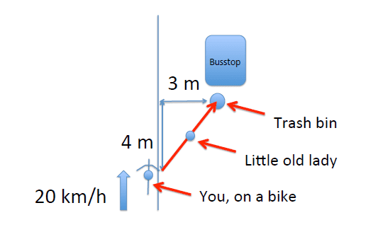

You are traveling on a bike, moving at a constant speed of 20,0 km/h. You just finished eating an apple, and you wish to pop the core into a trash bin located by a busstop.The bin is 3,00 m from the edge of the road (where you are biking). You throw it at a point 4,00 m before you pass the trash bin. The apple core behaves as a projectile under the force of gravity g = 9,80 m/s^2, and you can ignore friction and wind. The height of the (top of the) bin is the same as the height of your hand as you throw, 1,00
m above the ground.
a) You throw the apple upwards at an angle of = 20 degrees with horizontal. With what initial velocity vector relative to the Earth should you throw the apple to hit the bin?
b) With what initial velocity vector relative to you and the bike should you throw the apple to hit the bin? What speed does that correspond to?
c) As it happens, a little old lady is standing exactly halfway between you and the bin. She is 160 cm tall. Do you hit her? Remember to draw a sketch of the situation.

In (b) I struggle with getting started. If the bike relative to the Earth is the velocity vector in y-direction (20 km/h), and the the apple relative to Earth is the second vector. Then the velocity vector for me relative to the bike is the opposite vector from the angle? I am really stuck on this one, hope someone can help me here:)
Could you solve the problem if the bike was not moving? If you can, just subtract the velocity of the bike from your stationary solution.
I concur that the total velocity in the direction of travel is what you found for part (a), |V|=8.73m/sec.
What portion of that is in the +z direction? What portion is in the xy plane? Of the portion in the xy plane, what are the x and y components?
Subtract off the velocity of the bike from the y component and you should have a solution.

In a), don't you need an angle in your answer because they are asking for a vector? know its relative to the earth, therefore i am not exactly sure if you need an angle in your answer
I assume that the problem is asking for the vector in component form.
## \vec V = V_x \hat x + V_y \hat y+V_z \hat z##.
The velocity of the bike is pointed in my +y direction, so in vector form,
## \vec V_{bike} = 0 \hat x + V_{bike} \hat y+0 \hat z##, where
##V_{bike}= | \vec V_{bike} |##
For part b, the vector describing how you throw the apple is exactly ##\vec V - \vec V_{bike}##
But the magnitude of that vector is not ##|\vec V| - |\vec V_{bike}|##, since you can only directly subtract magnitudes if the vectors are pointing in the same direction.
Is this correct method on b?

How did you get the angles 53.5 and 36.7?
36.7 is the angle between where you start throwing and the red arrow. 53.3 is 90-36.7. But should probably not use them.
The angles are fine. Notice that you can keep a more precise answer by saying that the right/left component (x in my diagram) is 3/5 the total 2d velocity, and the front/back component (y in my diagram) is 4/5 the total 2d velocity.
Otherwise, cos(53.3) = .5976, cos(36.7) = .8018. These are probably close enough to not affect your rounding...but why go through the effort of finding the angles when the side lengths are given to you and the hypotenuse is simple enough to figure out?
Vxi=Vi*cos(36.7)*cos(20)=6.563 m/s
Vyi=Vi*sin(20) = 2.986 m/s
Vzi=Vi*cos(53.3)*cos(20)= 4.922 m/s
Vxrel=Vxi - Vbike= 6.563 - 50/9 = 1.007 m/s
Virel = Vxrel / cos(36.7)*cos(20)= 1.007/ cos(36.7)*cos(20)= 1.18 m/s
is 1.18 m/s the initial velocity vector relative to you and the bike should you throw the apple to hit the bin?
1.18 m/sec is a speed. And no.

You cannot directly subtract the magnitudes of the velocity from each other. This only works when the velocities are pointing in the same direction.
The total velocity of the apple when it starts its journey is 8.731m/sec. And it is pointed at a 20 degree elevation, right toward the trash can. In the x-y plane, it will have a straight line course, in the plane drawn between z and the direction of travel, it will have a standard parabolic ballistic trajectory.
You can answer part C based on the initial angle and initial velocity.
For part B, you need to break the velocity into components, x- component, y-component, z-component. Double check your components with
##v_x ^2 + v_y^2 + v_z^2 = V^2 ##.
Once you have components, you can directly subtract the velocity from the bike -- component-wise. That way you are only dealing with velocities in the same directions.

First, break the initial velocity into its components.
8.731 * sin(20) is your vertical component
8.731 * cos(20) is your flat component.
3/5 ( 8.731 * cos(20) ) is the portion of the flat component moving to the *edit* right.
4/5 ( 8.731 * cos(20) ) is the portion of the flat component moving forward.
Then, and only then, can you subtract the velocity of the bike. And, you only subtract the velocity of the bike from the component pointing in the same direction as the bike.
Once you have done that, you have your answer...in vector component form.
If you want to see the speed, then take sqrt ( [8.731 * sin(20)]^2 + [3/5 ( 8.731 * cos(20) ) ]^2 + [ 4/5 ( 8.731 * cos(20) ) - Vbike ] ^2 ).
That is the speed in the direction of the throw.
