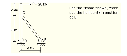

As shown by the attachment we are given the distances and the 28kN force
relevant equations are equations of equilibrium;
ƩFy & ƩFx = 0;
ƩM = 0;
First found By by summing the moments around point A;
(clockwise positive)
i.e.
ƩMa = (28*0.6) - (By*0.3) = 0
which gave By = 56kN
Next I summed the forces in the x direction and then took the sum of moments around the point "C", then tried to solve the simultaneous equations for Bx
However, this gave the wrong answer and I have no idea where to go.
Any help is great, thanks :D
  • Diagram of a frame with a vertical member from a pin support at A to a point C at the top, and an inclined member from C down to a roller support at B. A horizontal force P = 28 kN acts to the right at the top. Dimensions 0.2m, 0.4m vertical and 0.3m horizontal are marked.

What is the moment about A of the force applied at C by the CB support? What does that tell you about the x component of force at C and at B?
