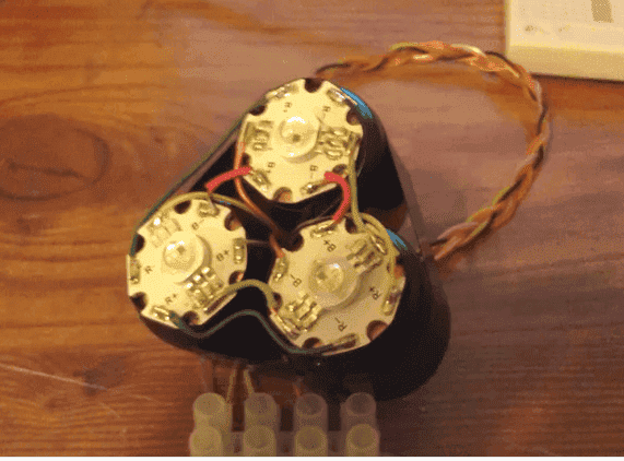

Hi,
We are currently working on a project that uses LED chips. Each chip has 4 contacts that need wires soldered onto them. The chip is about 1" x 1", with the contacts being fairly small.
What would be the most practical way to accomplish this? Does anybody know any reliable companies that could do this for us?
I'm considering converting my 3d printer into an automatic soldering machine but perhaps someone here can offer a better solution.
Thanks in advance

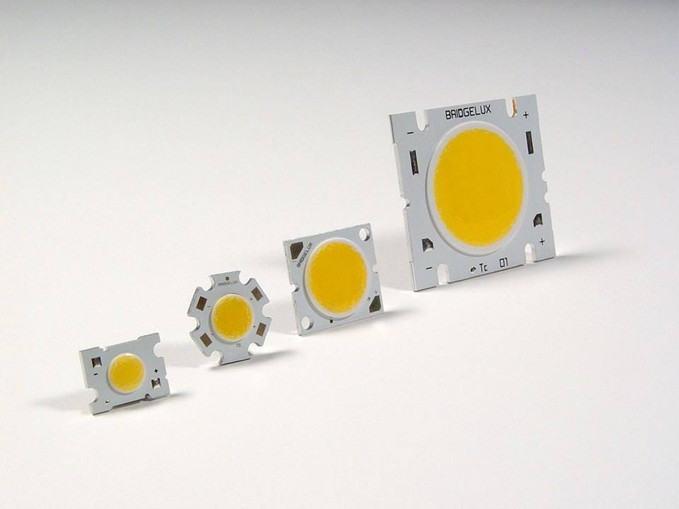

When you said "chips" I was thinking 0402 SMD parts. These things are an inch square?? Do they need heat sink? What is the application please?
The chips look similar to the 3rd one from the left (the square one next to the big square).
The SMT pads are only on one side.

You will need thermal contact to the case if you run these COB (chip on board) units anywhere near limit. What are the heat sink specs and does the manufacturer suggest a soldering protocol?

High power LED applications require careful heat sinking, so there are special ways to mount them to the metal. @hutchphd makes a good point that the manufacturer probably has recommended mounting techniques...
I'll look to see what I can find. A traditional PCB does not thermally conduct well...

Often for individual LED the board has thick copper both sides with many thruhole vias for heat conduction. There are also thick film techniques that incorporate aluminum heat sinks directly: I have not used them.

Destructively take a look at an LED lightbulb. Nontrivial technology of conductors laid onto aluminum plates. Why are you building your own lightbulbs?
The COB lights are very good (My basement lab is lit using one old PC power supply and COBs everywhere). I back them onto my steel air ducts. I am not sure they make sense for this. The heatsinks need to be good, copper is not cheap, and then you have to build them! But I will do what I can to help.

Here is an off-the wall idea: Is there a thick enough contact pad on the LEDs that you can spot weld a ribbon of metal to the pad and then to the power source?
Spot welding is commonly used to make battery packs and is a LOT faster than soldering. Typically Nickel ribbon is used, Copper mostly doesn't spot weld.
Another maybe is pressure contacts to the LEDs. Depends a lot on the environment though, both chemical and mechanical, to find compatible contact material. This approach could be enhanced for better contact by using Silver or Copper paste at the interface, as is done with high current (several thousand Amps) busbars.
