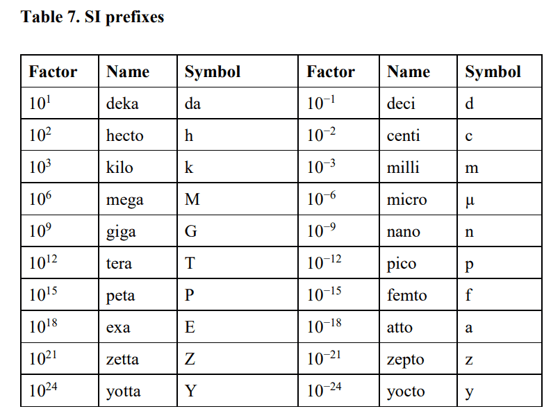

how come 7271000mm3 is equivalent to 7271cm3) ?
from mm to cm you should go back two zeros back right ?
No ! 10 mm = 1 cm
milli from mille, 1000
centi from centum, 100

From: https://nvlpubs.nist.gov/nistpubs/SpecialPublications/NIST.SP.330-2019.pdf page 23:
