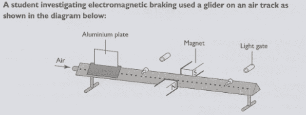

Q1: explain how the setup shown in the diagram acts as a break?
Q2: Electric and hybrid cars use regenerative breaking. At high speeds, the car can be slowed by reversing the direction of the electric motor so that it acts as a generator. Explain how this system operates in slowing down the car?
Answer 1: The aluminium plate is a good conductor of electricity. As the plate passes through the uniform field, the amount of flux linking with the plate changes and hence an emf is induced. Because of the nature of the aluminium plate (conductor) a small current will flow. The direction of this induced current is such as to oppose the change creating it.
The current-carrying aluminium plate will produce its' own magnetic field that interacts with the external magnetic field. By flemmings LHR the force on the plate acts to the left and hence acts to decellerate the glider.
Is this correct?

note: the currents induced are EDDY currents
