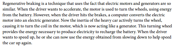

Can someone explain what regenerative breaking is?
no equations required
I understand that this occurs with electric cars. It uses the idea that the electric motor and the electric generator are so similar. But how does the electric motor that is causing the wheels to turn, transform into an electric generator that produces energy to recharge the battery and start the electric car going again.
I just need a clear explanation of what "regenerative breaking" is?
In regenerative braking, the motor is just functioning as a generator of electricity when you brake. Consider the motors at a hydroelectic power plant.
The water from a dam flows through the turbines and the motors generate electricity. This is equivalent to the car example when the moving car is forcing the generator to turn and the generated electricity is stored in the battery.
You could theoretically reverse the process in a hydroelectric plant by supplying electricity to the motors and force the water uphill. This is similar to the motors a car being supplied electricity from the battery to force the car to move.
