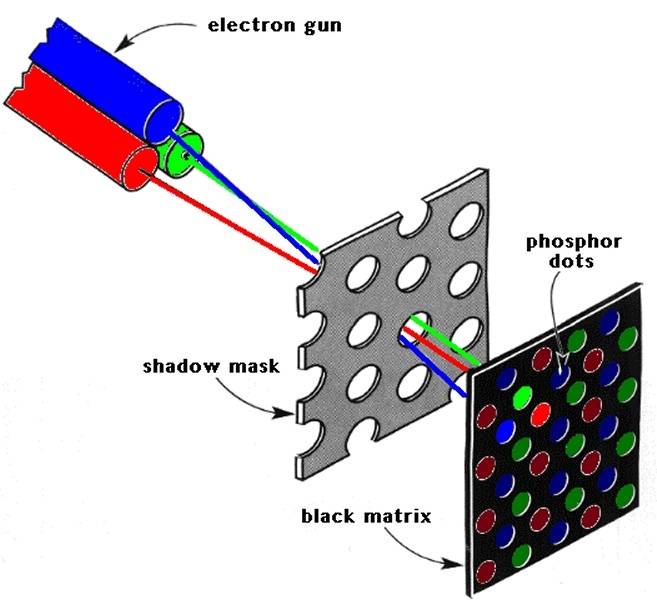

That was a real problem with colour TV CRT's. They had a mask with tightly spaced holes just behind the phosphorous. You had to adjust it as best you could, involving lots of compromises...
I doubt any of these TV's were experiencing problems because of electron diffraction.
That wasn't a problem of QM. The dimensions of an electron gun (and the whole CRT) take matters way out of the region of diffraction. Any beam spreading and also the resulting lack of colour purity is down to the very tight margins for a shadow mask (and the subsequent improvements) and the fields which deflect the electron beam. Electrons can be treated as 'simple' charged particles when you're designing electron optics in this context, I'm sure.

Svein said:
A detail that the diagram does not show is that the three beams have to come from the same virtual point in space, despite the electron guns and grids are fairly wide, so the shadow mask works onver the whole screen. (Also, the beams go through more than just one hole at a time to make the picture bright enough). The beams from the three guns have to be bent by magnetic fields to achieve this. No wonder those shadow mask tubes had to be set up every day for high quality stdio use. TGF LCDs.

The holes were close enough to create an optical grid...
