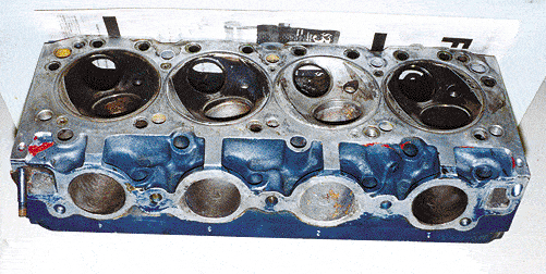

average guy
119
mechanical engineers
i looked at wikipedia article
http://en.wikipedia.org/wiki/Ford_385_engine
they don't quite answer the question.
the one you'd ask if you saw this engine at
a machine shop or car show.
what's going on with those valve covers/heads?

At first glance I would say it's a hemi based on the position of the spark plug. What is it exactly that you want to know?

about pic's.
i like the first pic.
clap clap clap.
second pice.
what's he been doing with that motor?:smile:
i haven't seen many heads the look like that.
Have A Nice Day!
Those are boss heads - a quick look at ebay shows those heads at ~4 to 6 thousand dollars.

The Boss 429 heads have rotated & canted valves. It is a TOTALLY differeny beast than the regular 429 wedge. Rare engine indeed. The basic 429 only ran from 1968 until 1972 when smog regulations came into concern Ford discontinued it. However, industrial applications kept using the 429ci displacement. The 460 and 429 were debuted in the same year, one is larger because it was designed for the Lincolns IMO.

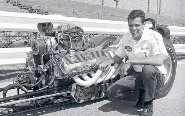

could it be one of these?
a big y-block sohc hemi ?
http://en.wikipedia.org/wiki/Ford_FE_engine
427 SOHC "Cammer"
SOHC engine showing cam, rockers and timing chains
Examples of racing 427 SOHC's
The Ford Single Overhead Cam (SOHC) 427 V8 engine, familiarly known as the "Cammer",[33] was released in 1964 to maintain NASCAR dominance and to counter the Chrysler 426 Hemi engine. The Chrysler 426 used an extremely large block casting that dwarfed the earlier 392 Hemi. The Ford 427 block was closer dimensionally to the early Hemis than to the elephantine 426 Hemi: the Ford FE bore spacing was 4.63 in (117.6 mm) compared to the Chrysler 392's bore spacing of 4.5625 in (115.9 mm). The Ford FE's deck height of 10.17 in (258.3 mm) was lower than that of the Chrysler 392 at 10.87 in (276.1 mm). For comparison, the 426 Hemi has a deck height of 10.72 in (272.3 mm) and bore spacing of 4.8 in (121.9 mm); both Chrysler Hemis have decks more than 0.5 in (12.7 mm) taller than the FE.
The engine was based on the high performance 427 side-oiler block, providing race-proven durability. The block and associated parts were largely unchanged, the main difference being use of an idler shaft instead of the camshaft in the block, which necessitated plugging the remaining camshaft bearing oiling holes.
The heads were newly-designed cast iron items with hemispherical combustion chambers and a single overhead camshaft over each head, operating shaft-mounted roller rocker arms. The valvetrain consisted of valves larger than those on Ford wedge head engines, made out of stainless steel and with sodium-filled exhaust valves to prevent the valve heads from burning, and dual valve springs. This design allowed for high volumetric efficiency at high engine speed.
The idler shaft in the block in place of the camshaft was driven by the timing chain and drove the distributor and oil pump in conventional fashion. An additional sprocket on this shaft drove a second timing chain, 6 ft (1.8 m) long, which drove both overhead camshafts. The length of this chain made precision timing of the camshafts an issue to be considered at high rpms.
The engine also had a dual-point distributor with a transistorized ignition amplifier system, running 12 amps of current through a high-output ignition coil.
The engines were essentially hand-built with racing in mind. Combustion chambers were fully machined to reduce variability. Nevertheless, Ford recommended blueprinting the engines before use in racing applications. With a single four-barrel carburetor they were rated at 616 horsepower (459 kW) at 7,000 rpm & 515 ft·lb (698 N·m) of torque @ 3,800 rpm, and while equipped with dual four-barrel carburetors they made 657 horsepower (490 kW) at 7,500 rpm & 575 ft·lb (780 N·m) of torque @ 4,200 rpm. Ford sold them via the parts counter, the single four-barrel model as part C6AE-6007-363S, the dual carburetor model as part C6AE-6007-359J for $2350.00 (as of October, 1968). Weight of the engine was 680 lb (308 kg).[34]

pic shows what engine was intended for.
that's young don prudhomme in pic.
