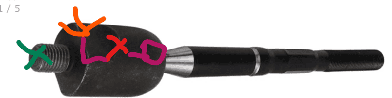

I know inner tie rods come pre-greased, and should be good for a very long time. But I was hoping to add grease into mine every now and then to extend their life. I noticed that some (but not all) inner tie rods have a little hole on the side where a wrench can be put on.

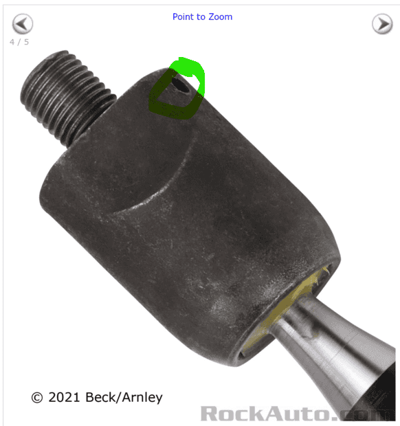

Photo of a black steel inner tie rod end with threaded stud on the left and tapered shaft at the lower right, showing a small hole marked with a green outline near the top of the housing.
I was thinking at first that the hole is how grease is injected into the ball joint at the factory. However after getting this part, it is clear that this is not the case.

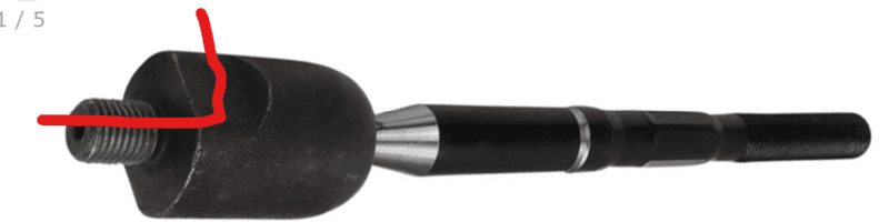

Photo of an inner tie rod with a black housing, a threaded stud on the left, a tapered shaft and a long threaded end on the right, with red markings drawn over the housing.
There's a hole in the stud (for what purpose I do not know) and you can look through it and see the hole from the first picture, meaning that the two are connected together, sort of like a giant "L" shape, that goes no where, and seems to have no apparent purpose as far as I can see.
So I have no idea, what is the purpose of these holes?
I was thinking that maybe I could stick a drill bit inside of the rod with a hole in it (green X in the picture below) and drill a hole through the metal at the location of the red X. Eventually I would get into the ball joint area. I could then block of the hole in the stud with a plug, and put a zerk fitting where the other hole is (orange arrow)
Photo of a black inner tie rod with a threaded stud on the left and a long shaft on the right, with hand-drawn red, green, orange and magenta marks on the housing.
Has anyone ever tried to do something like this before, to add grease into an inner tie rod? I find it really strange, that there's no provision for adding grease. With the rest of the metal housing being mostly round, there's not really another good spot to install a zerk fitting. Is my only option to really occasional remove the boot, and use my hands to manually force grease into the ball area?

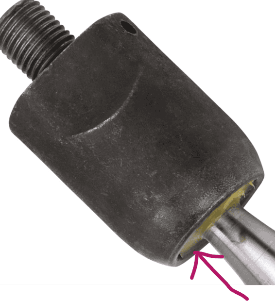

Close-up of a dark metal inner tie rod housing with threaded stud at upper left, a small side hole near the top, and a red arrow pointing to the boot end where a yellow-tinted bearing sits around a silver ball stud.
How do they add grease at the factory? I tried searching of a packer tool for inner tie rods. Some sort of tool that grips onto the inner tie rod to create a closed container, and as you pump grease in it forces it's way through. Kind of like a bearing packer tool. But there appears to be no "inner tie rod grease packer".

I would expect the inner tie-rod end to be protected, inside the rubber boot, on the end of the steering rack. That grease should last until after the rubber boot fails, when water and dirt may be introduced. Until then, only a small amount of steering rack lubricant fluid should be present inside the boot.
If you attempt to grease the inner tie-rod end, you will have to remove the rubber boot, and will then introduce dirt into the joint with the grease.
There is less angular movement at the inner end of the tie-rod than the outer, so it should displace the grease and wear only very slowly, until the boot fails.
By all means grease the outer tie-rod end that is more accessible and has greater movement. The elbow of the outer tie-rod ball joint makes it possible to introduce grease through an external grease fitting that is not covered by a rubber boot.
The inner tie-rod end is usually assembled in a press, so there is no easy way to disassemble the joint, to drill and thread it for an external grease fitting, which would then project, to foul and damage the protective rubber boot.
When you turn the steering, the boot volume on one side increases, while on the other side, the volume decreases. That 'L' hole communicates through the centre of the rack with the other side, so air pressure can equilibrate, and the boots are not blown off. The volume of the steering rack chamber has lip seals at both ends to retain the fluid, so air cannot be allowed to flow that way, since it would push fluid out through those seals, into the rubber boot.

First, notice how the outer end of the housing has been pressed to close around the exposed end of the ball. I circumcised a used joint in a lathe, to see how it was assembled inside. The housing material is an unusual steel, carefully chosen to be malleable and is very easily machined. The housing wall was thicker than I expected, maybe that is to compensate for the malleability during assembly and operation.
The polished ball on the inner end of the rod is surrounded by a plastic bearing material, moulded as two separate parts. There is a plastic cup that sits deep in the housing, and a plastic barrel section, (spherical inner, cylindrical outer), that slides down the rod to slip over and surround the ball. It is greased as it is assembled and only then slides into the cylindrical bore of the housing. The two plastic parts fit well together around the ball without any gap.
The housing is then placed in an axial press that closes the rounded end with a die, capturing the ball in the then tightly compressed plastic bushing. There are small channels on the outside of the plastic bushings, that allow any excess grease to escape during assembly.

The two flats are used to grip the tie-rod end.
The round hole is the 'L' shaped air vent through the threaded connection with the rack.

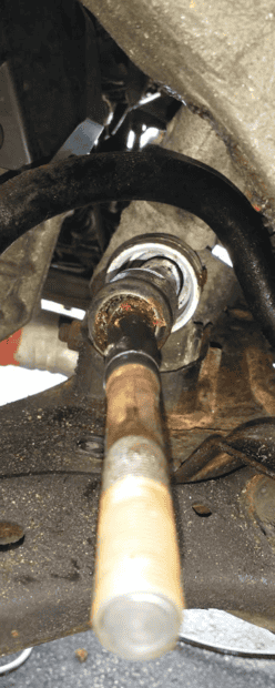

Photo of a removed steering rack end under a car, with a worn inner tie rod attached; the exposed rack shaft shows dark greasy residue near the inner ball joint boot.

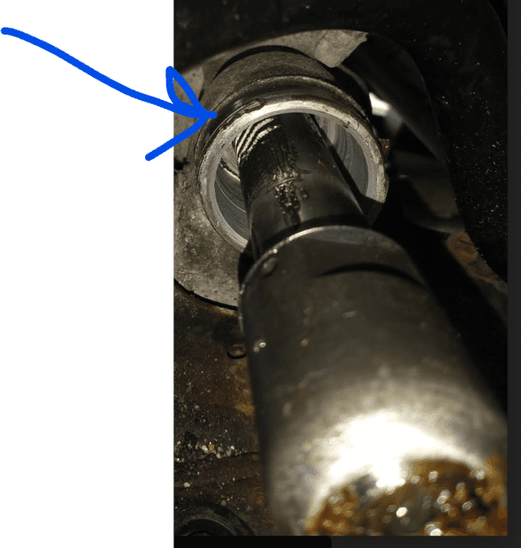

Close-up photo under a car of a steering rack end with the inner tie rod removed, showing the exposed rack teeth and dark greasy residue, with a blue arrow pointing to the rack housing opening.
This was from the car, with the old inner tie rod which was extremely worn out, but I can see the teeth of the rack and pinion, it's not in fluid at all, and appears to be grease on it (but it might just been grease seepage from worn out inner ball joint.

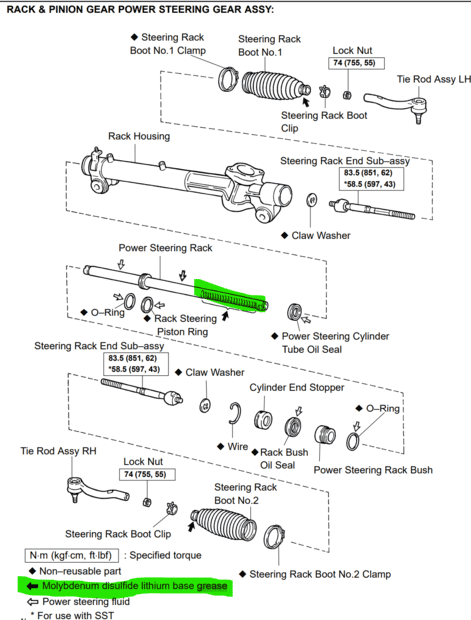

Exploded diagram of a rack and pinion power steering gear assembly with parts labeled, including the steering rack boot, rack housing, power steering rack, piston ring, O-ring and tie rod assemblies. The power steering rack teeth and a note reading Molybdenum disulfide lithium base grease are highlighted in green.
Looking at the service information, very interesting indeed! From this it looks like the side of the rack with the teeth is supposed to have grease on it, and there is an o-ring, and piston ring to create a seal. It's like the side of the rack with the teeth, the teeth part is not exposed to PS fluid (which in this case the service information says to use ATF.
I've never heard of someone greasing their power steering rack as preventive maintenance. But it seems like I have 20 year old grease on my rack. There's still some there, just well after 20 years, probably good be regreased? I wonder if it can be over-greased. Is the point of this grease in this application to prevent rusting, or is for metal on metal wear prevention, or I guess even both?
